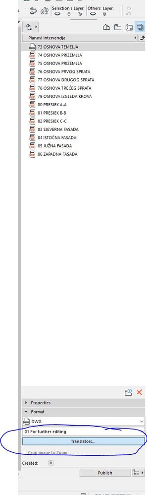

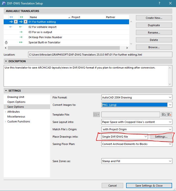

When you go to Publisher, go Translator (picture 1) , on For futher editing or something else you pick, select Under place drawings into: Single dxf /dwg file.
Than you will get a dwg file with all pictures inside.
If however inside folder where is dwg file there are still pictures that you have used and youre dwg file needs those pictures to show them, than you need to attach them inside AutoCAD software. After attaching you can easy delete used images.
Attach a image inside AutoCAD- can be easily found on YouTube
Santi Lombana
Thanks Miki!
I have tried that, it won't embed everything unfortunately but will try doing it with Autocad! Thanks again!.
