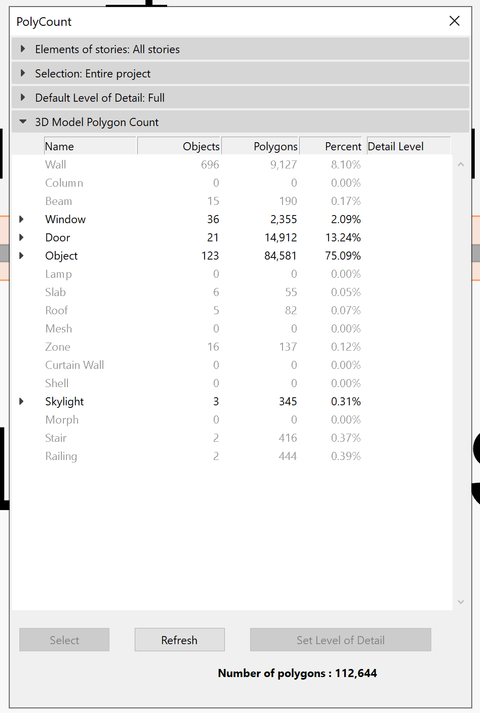

I noticed this project had been creeping up in file size but was so busy i ignored it.
Then when I was republishing I noticed a layout was missing and I def didnt delete it.
I realise you are meant to only link large bitmap images but in the heat of deadline I forgot to link them back out after placing...
Now the file size is over 450mg for a pretty simple house!
So I stripped out all the data, images, model etc...ie its empty and its still 81mg vs 20mg for a clean start file...
Where do you start with sorting this out?

Shrunk it a bit 381mg>315 but this is still hugely bigger than it should be. Poly check at full 3d is pretty modest and nearly all of the bitmaps are linked. There is
