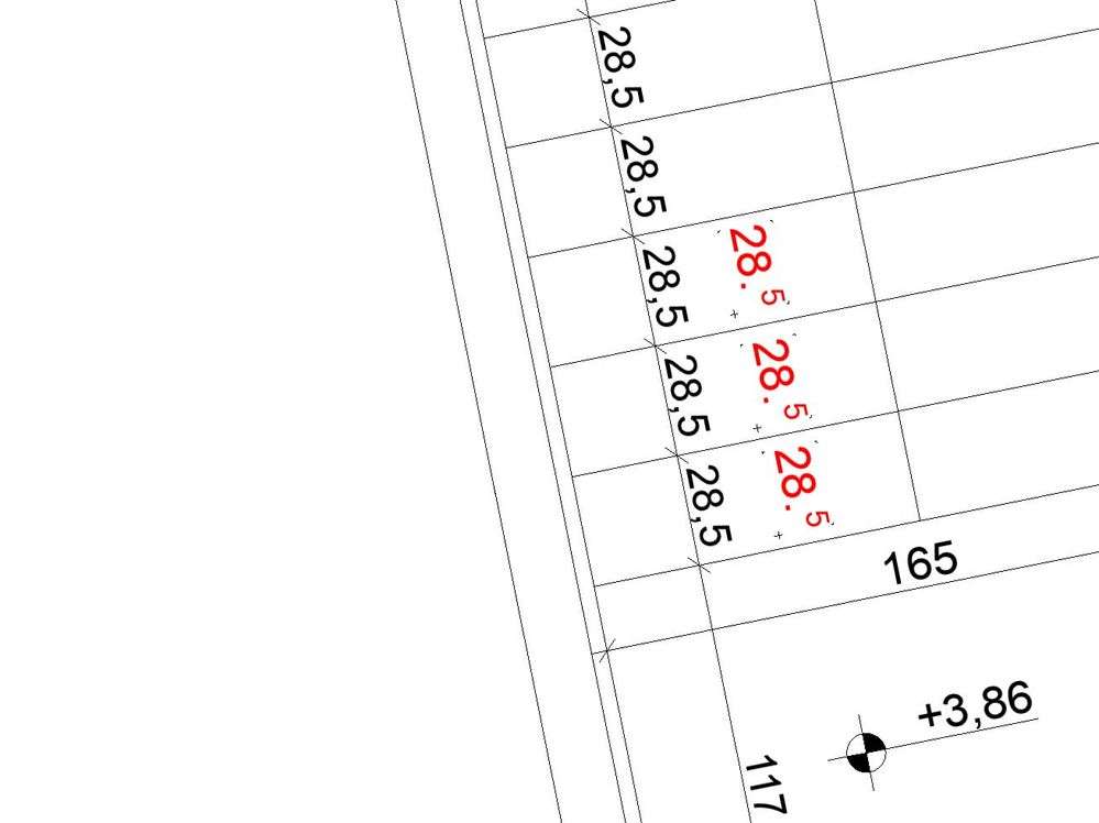

I'm wondering if there's a way to set dimensions properties in order to obtain a desired look as follows:
so instead of having this usual style of decimal dimensions:
it would be so much better if the dimensions could look like this (it would require less space) - i.e. decimal numbers would be written in a superscript manner:

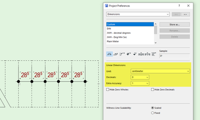

Sure.
In your dimension style you want to set as centimeter with no decimals and 1 for extra accuracy.
Don't forget to store it as a dimension style name so you can set that style for you views in the view map.
This will of course apply to all other dimension in that view.

Thank you so much, works perfectly!!
