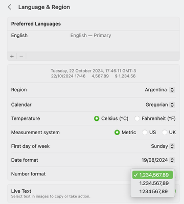

MacOS, how do I get *no* thousands separators in dimensions (no comma, point, space)
How does one show dimensions in mm without thousands separator, on MacOS? On Mac number formats are controlled by System Settings > General > Language & Region, but I can't find no separator as an option (7825 mm, neither 7,825 nor 7 825). Changing Measurement System from Metric to US to UK does not modify the options available here.
[And I can't even make do with space, because I am needing point as decimal separator.]
On previous OS versions you could do that, https://www.youtube.com/watch?v=oMEerRSdEHU , but I can't find anything similar on OS 13.
Operating system used: Mac Apple Silicon 13.6.9

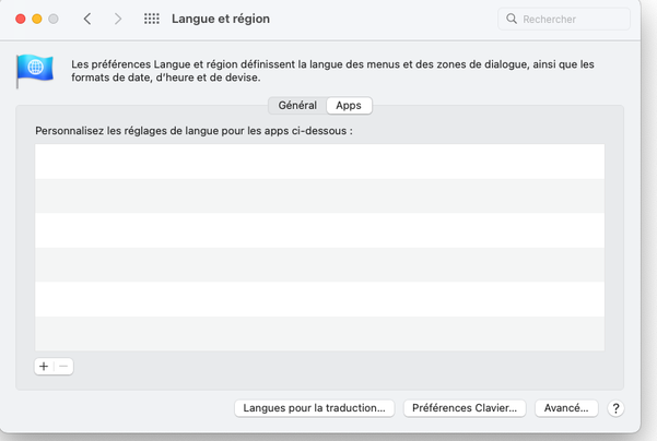

Yves
before macOS 13 …

BrunoH
Try to change the region to France, the window you show there is the french one.
You can adjust the settings on an Apps basis.

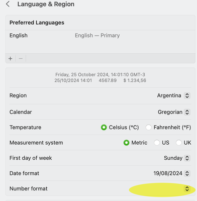

@vlahtinen wrote:
I think that you can just choose the regular option from the system settings.
Thank you so much. Yes, System Settings gives you a way back; after the Terminal touch-up the Number format field shows blank (does not display the customized format), but the pop-up still gives you the system-built options as a return path. And apparently Archicad only cares about the settings when one opens the file, so one can go Terminal, open the Archicad file, and immediately restore normal system settings so as not to mess up the other applications. It seems. I hope. I’ll edit and comment otherwise.
