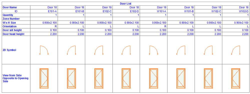

In the attached screenshot you can see the result I got when I scheduled the Doors. It shows that for me that all Doors got their IDs correctly, the IDs were concatenated correctly based on the nested Hotlink Structure and the specified Master IDs.
