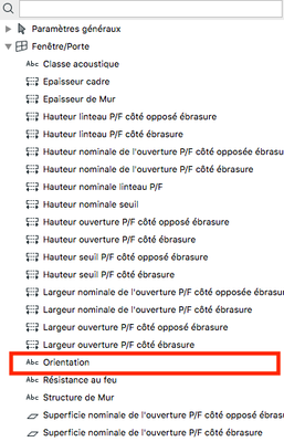

Yves
On the French version this parameter exists
