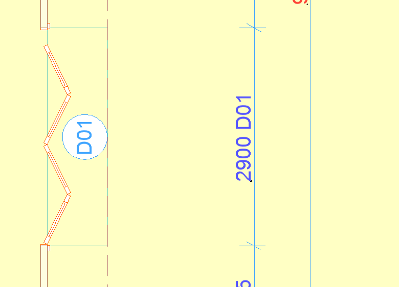

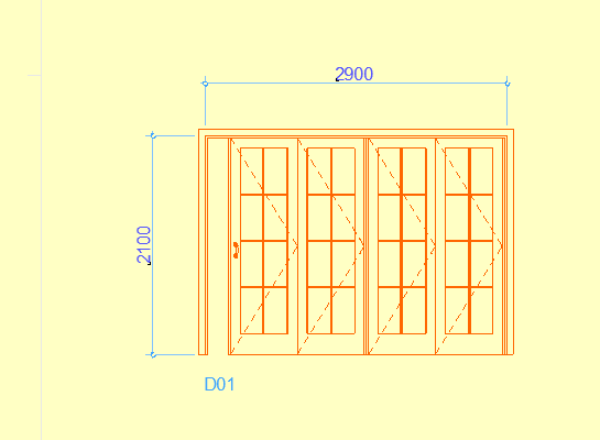

Thanks Stu, sorry I should have mentioned I am using Archicad doors & windows with Cadimage schedules.
I definitely have the doors placed correctly, there are casings on the outside in the dialogue box & outside on plan.
But they are showing on the schedule viewed from inside.
This plan was started in Start Edition 2014, then moved into AC18
I have just opened a new plan file (AC18) placed some doors, opened the door schedule all show from outside!

Attached is screen shot of door from the plan & the schedule
Schedule
I have sent file to tech support, its a glitch in the translation between Archicad doors & Cadimage schedule.
Priority fix for next update.
