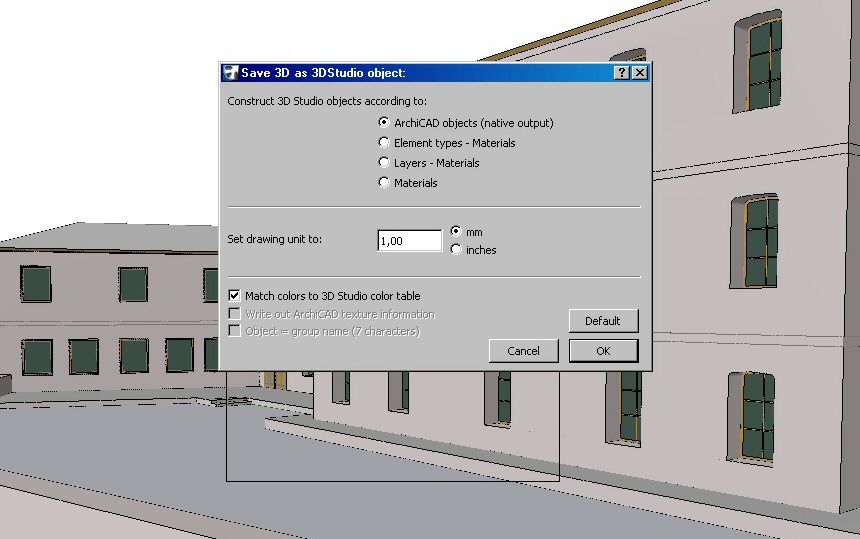

i want to save my archicad 3d as 3ds tou open it in 3d studio.
it pops up these questions that i have no idea what to do with them
i work with meter unit if this is needed.
what should i do?

SELECT "MATERIALS"
AND IN mm 10

OK,
I draw in cm and thats 10 cos 10 mm is 1 cm
so i will get right scale in 3ds
But when i export like this and import in sketchup i have to upscale 100 time to get right scale
So try with 10, and see will 3d model will be exact size like in archicad, and change this nubmer if needed.
