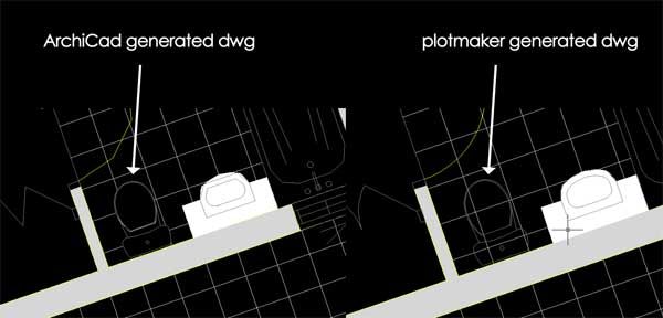

Wokka wrote:what if you use the 'wipe-out' pen (-1) for all of your background fills? it comes with its own problems, but might work in this case?
Any other idea's. Anyone...........anyone?

Wokka wrote:hmm - i found this elsewhere: "Fills with curved edges can not be translated into Wipeout since it can be only rectangular or polygonal." it also sounds as though this is an autodesk limitation. but:
~/archiben,
Thanks for the idea. That's what I use in the ArchiCad export and it works fine but as soon as I save out of plotmaker it no longer works.
If anyone has a few minutes, could they test it on R9?

[and what happens if you go the other route? i.e. use background fill pen 91 (white) and go the traditional route?This doesn't work out of ArchiCad or Plotmaker.
