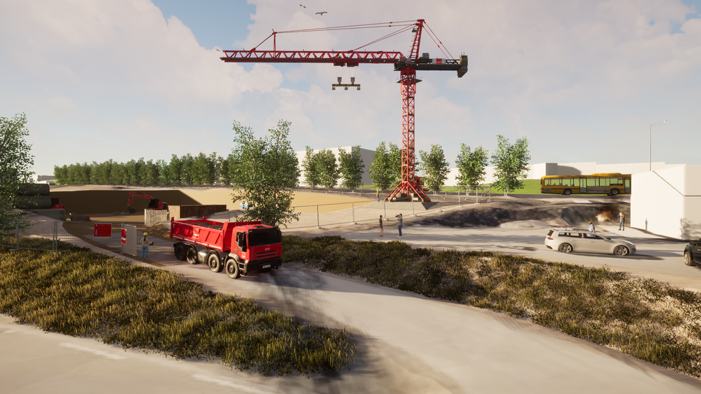

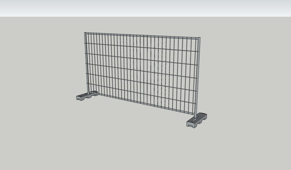

Can anybody assit or guide me in creating a parametric object, similar to the attached (parametric Sketchup model) of a construction fence that will follow a line on an uneven terrain surface?
I used Profile Builder 3 to create a profile and somehow managed to have it follow a path on a terrain, but not very good result and want to try and create a similar object in Archicad 25.
We make a lot of Site Layout plans in 3D (see image7) and its really the fence that's the most time-consuming to place.

Have you tried the railing tool? You may even be able to create the support feet as custom posts.

Custom post with two railings and a texture for your wiring.

Haven't really worked much with the railing tool, only used predefined railings, but it might be a solution.
