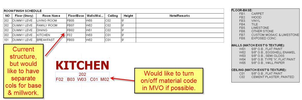

Scott Bulmer
Rengarch,
I have reviewed your schedule and zone stamp and really like what you have done. Your schedule appears that it will work well for complex projects.
I have attached a screen-shot of a proposed schedule for more basic projects that I think can be somewhat effective, but not as complete as yours.
I know how to add columns to the interactive schedule, but what modifications will be required to the zone stamp to make it appear as in the attached image, with 5 or 6 columns separated by vertical lines depicting the material codes (2 or 3 codes need to be added)? Also in the listing box, the material code could be broken up into multiple rows if necessary. The material codes entered in the zone stamp parameters (totaling 5 or 6) are required to be scheduled.
Finally, it would be nice to switch on/off the listing box below the room name using MVO, so that the box could be on for a finish plan view set, and off for a typical floor plan view.
Any thoughs will be appreciated.

TomWaltz
Unfortunately, only Graphisoft can add MVOs. Unless they make the ability to make your own or add "show finish box in Zones", it's not possible.
Tom Waltz

Scott Bulmer
MVO = Model View Options.
Thank you Tom for your comments.
I will sincerely appreciate it if someone gifted in modifying the script of the default zone stamp can suggest a way to change the 3 fields of material code to 5. Further, if column division lines can be added to the listing box located below the room name. Please refer to my earlier post.
Thanks, Scott

rengarch
I was not able to toggle on/off in Model View Options. You need to figure that one out yourself. You can change the headings under the schedule. Hope this helps you.
