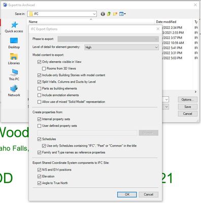

The engineer needs set up their IFC Export options to split walls/columns/ducts by level.
