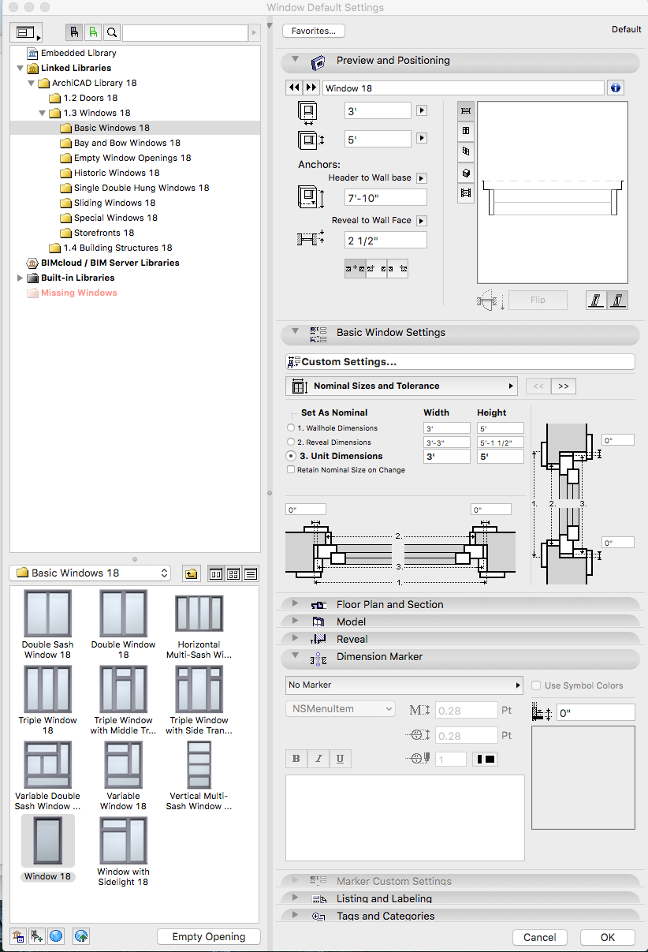

Here is a screenshot of the issue.

toman311
Hey David,
Yes, I am using the ArchiCAD 18 Library. The "ArchiCAD Library 18" is located... I'll just post a screen shot of where I get my building components..... Apparently I can't add two attachments to one post, so I'll make another post with the screenshot.
Attached is the Window Schedule Scheme Settings.
I guess I should mention that I have never used an Interactive Schedule before with 3D components. I wasn't going around clicking buttons, but maybe the problem is something simple. I'm not sure though.

toman311
Here's the path to ArchiCAD Library 18 where I get all of my building components.

toman311:
It looks like you are using the INT, not the USA Library (which version of ArchiCAD do you have? INT, USA or other? Your location says USA), but the library is not the issue here.
The two units you have having an issue with are reading the Calculation Units & Rules settings (which don't have fractional inch options) rather than the Dimension settings. If you load the parameters shown in my screen shot (Frame Thickness for Thickness, and W/D Nominal Head Height for Sill/Header Value) at Scheme Settings > Fields, the correct unit will show. I did not get into this enough to figure out why some units are read from Dimensions and others from Calculation Units & Rules, maybe someone else can chime in.
