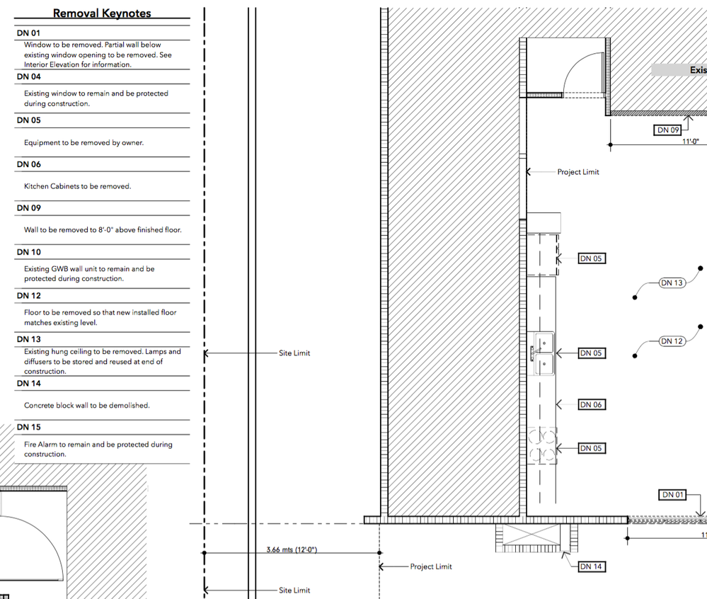

Eduardo Rolon
I usually coordinate Labels by reading the information of the object. In 90% of the cases the object has the following info:
• Renovation Status
• CSI Keynote # for finishes or type
• Building Material has Keynote # and Specification
Based on the drawing the Label reads the information that I specify and the schedule reads the info that it needs.
Attached quick sample that reads a Keynote Number from the Object and the Schedule lists the Keynote Number and the Description. Done in AC17.
