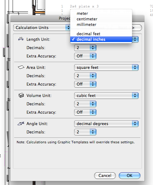

I am actually trying to use the quantity calculation features on some large projects and have run into a snag I can't figure out.
Creating linear components in the database I have set the unit to lineal feet and the Reference Quantity to "Length". I would assume that it would calculate the quantities per lineal foot but instead its interpreting the values as per lineal inch and I am getting 12 times the amount that it should be.
I realize that I can force it to work by setting my quantities per inch but this offends my sense of what is good and proper (0.0625 studs per lineal inch? yuck!) and I would really like to make it right. Unfortunately the manual seems to be mum on the subject.
Anybody know how to set the Reference Quantity units?

Thanks for the reply, but my problem is that whether I use pieces or lineal feet it is calculating the length based on one inch units. In other words to get 1 stud every 16" I have to set my quantity as 0.0625 studs per length unit (inch) and the plates at 0.0833 ln ft per inch. There has to be a setting somewhere in this clutter of dialogs to change this but I am at a loss so far to figure it out.

I think you might have inches selected under Project Preferences > calculation Units. I just went in and changed mine to inches and the studs for a wall went from 16 to 198. So.....
