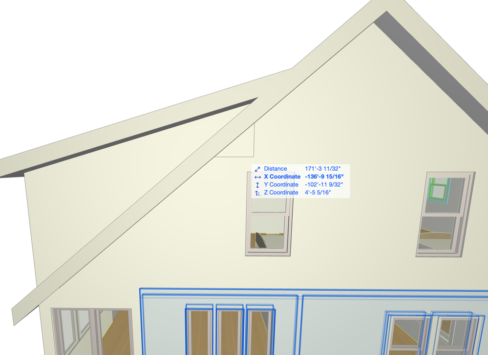

Lines on exterior elevation
I have tried to change the settings in order to get rid of that rectangle. I know the line at the base represent an elevation line i.e. attic floor level.

If you have overlapping faces you will need to use seo or stop the overlap

Hi @2raarchitecture,
I second @SenecaDesignLLC! However, if you haven't solved the issue yet, could you drop here a 3D cut view through these lines?

2raarchitecture
Seneca, please, what is SEO in the context of Archicad. I don't know that one. I remember lining things up to solve this. I am also much aware of floor levels to make sure walls are not set to extend a dimension up or down.

2raarchitecture
Rubia, for the project at hand, this was solved, but I saw it showing up at another project. I will be attentive and report back if any trouble. Last, some relatives are last named Torres, so It was a welcome surprise to see your name here! Thank you!

Solid element operations.

Rubia Torres
Hi @2raarchitecture. If you are interested in learning more about SEOs, we have this user manual at hand. And what a nice coincidence you have some Torres folks in your family. My lost cousins 😄
