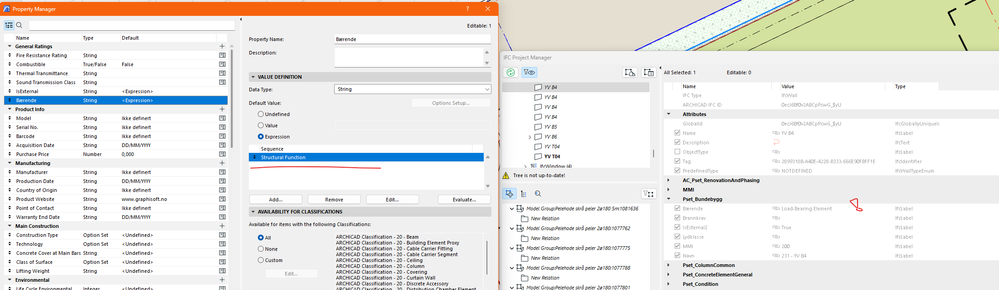

Load-Bearing or Non-Load-Bearing as True/False in custom IFC Pset

Hi
WE have client demanding additional Pset with different things,
IsExternal I've found here on forum, and it works as a charm. I tried to do similar thing with Structural Function, but I guess there must be an Expresssion that do the magic and return True/False instead of Load-Bearing Element or Non-Load-Bearing Element... what should I write there?
Consider me as a noobie ;D
Rafal

Solution
Decumanus
And the answer is .... (drumrolls) ... IF ( Structural Function = "Load-Bearing Element"; TRUE; FALSE )
Chat GPT helped!!!! :)))
