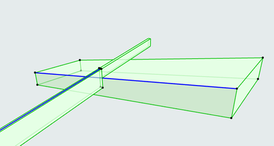

I have to beams acting up when a third one is cutting throug:
This is a part of a roof: Two gurters and a loadbearing beam... I guess the image speaks for itself?
So - bug or feature?

I have replicated what @Kamelite says and the same thing happens to me.
I have tried to change the priorities within building materials, created a subtraction, changed the reference point of the profile, etc. but the problem persists.

This is just AC trying to intersect beams with colliding geometries where the start/end of one happens to lie on reference line of the other in the XY plane - doing so by extending the one of them to the boundary of the other. You know - just like things usually are to be built....
To prevent it the beams has to be in different layer intersection groups which wouldn't be such an issue if it weren't tied to layers and in turn views... and who the heck thought it was a good idea to has intersection as standard and not the exception.

This is another architect programmers idea of how things are built in the real world... that is wrong. In the real world I would expect the lower beam to notch the upper beam, not change its profile. And if AC can't resolve it, leave it to the user to form the cut.
I will report this to Graphisoft. Until then, one workaround is to model the load-bearing beam using the Wall tool. That will product the desired result.
