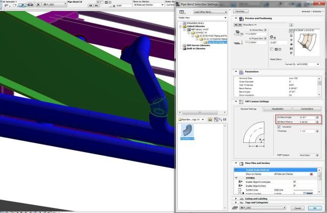

I am currently working on some drainage pipe routing and can't figure out any way to limit the MEP modeler to use ONLY standard bends.
As you see in the attached screenshot, the MEP routing function has created a bend of 37.87 degree. This type of bend is non-standard and will need to be custom made, hence, not realistic for actual construction with normal budget.
Am I missing any settings that can make the auto-routing use ONLY standard bends? i.e. 1/4 bend, 1/5 bend, 1/6 bend, etc... I've set the standard bend angles in MEP preferences, but that doesn't prevent the system from using non-practical angles.
Please help, and thank you in advance!

In your example, you have a very tight space to work, however, if possible, try this.
In my experience (and exasperation with MEP) after placing any pipe itersecting element (T's, Y's. etc) the only way to connect and continue piping in the same direction/slope/angle of the elbow is to snap a small straight section at the free end of the elbow. Do not attempt to START ROUTING, instead modify the parameter lenght of a straight pipe and give it a 2"or 3".
Snap these small pipe section and then continue if you wish with ROUTING.
Hope this help you
