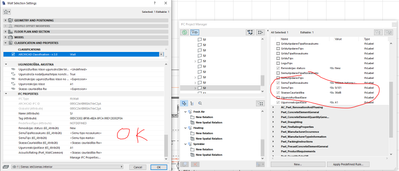

Have a problem:
Why is it so that in Archicad 26 mapped IFC proprties does not show correctly in Element settings dialog?
Whenever I do exactly the same mapping procedure in AC23, for instance, IFC Properties are shown correctly in Element settings dialogue.-
What could be the cause?
Thank You,
Kaspars
1 REPLY 1
Can you show an image of the Map IFC Properties for Export Dialog where you created these IFC Properties?
Actually, is that where you created the IFC Properties?
Or, in the Wall Settings Dialog, did you click the "Manage IFc Properties" button and click "New" to create the IFC Properties? If you did the latter, the IFC Properties will be available only for the Walls selected at the time of the creation of the IFC Properties. If they are created in the Map IFC Properties for Export Dialog of the IFc translator Dialog, they should be available to all Walls.
