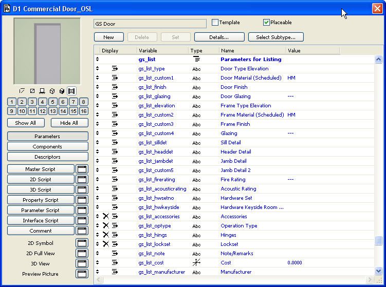

Attached is a screen image of our typical listing parameters -- the real pain is putting them in order in ALL door objects (not necessary, but makes inputting the data via the object a lot easier).

Fantastic. Thanks. I see the object parameters now and the means to change or add any new ones. I suppose if I want custom listings, I should add them rather than modify the basic Archicad parameters, right? If we ever interface with a contractor, they might want to know how much a door weighs for figuring freight charges.

The UI for the AC12 doors is in the Interface Script of the "ui_door_side_list_usa" macro -- it can be pretty tricky if you don't know what you're doing -- I believe I just replaced the standard fields with the ones I wanted to list and made a few small adjustments.
