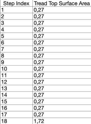

Is there a way to schedule these elements of a stair?
1. the area of the threads (landing included) - blue in the picture
2. the area of the risers - red in the picture
For both of these the relevant area should not include the sides or the backs of the elements. The area should represent the square meters of material of the finish.
In the stair finish listing parameters I cand find "Tread Top Surface Area", wich is very close for the first one, but it dosent list the finish of the landing. Also there is a "Total Sur­face Area of Stair Finish" wich lists the area of the risers, butt the overall area, not just the area of the face. I dont seem to find any other usefull parameters that I can use in a expression to produce a are to schedule.
Is there something i'm missing?

You can edit the stairs and adjust the thread.
The shedule can list the thread with 'Step Index' + m2

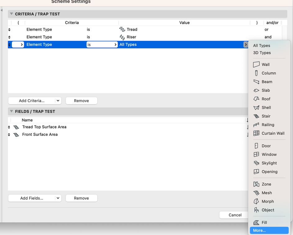

Under element type you can find the Tread & Riser under more....
In the field there will be two surfaces available when you have the tread en riser selected:
Frond Suface Area

Thank you Cuba.
That seems to work. Can you think of any way to have the thread area include the landing area? Or a way I can get the landing area separate?
