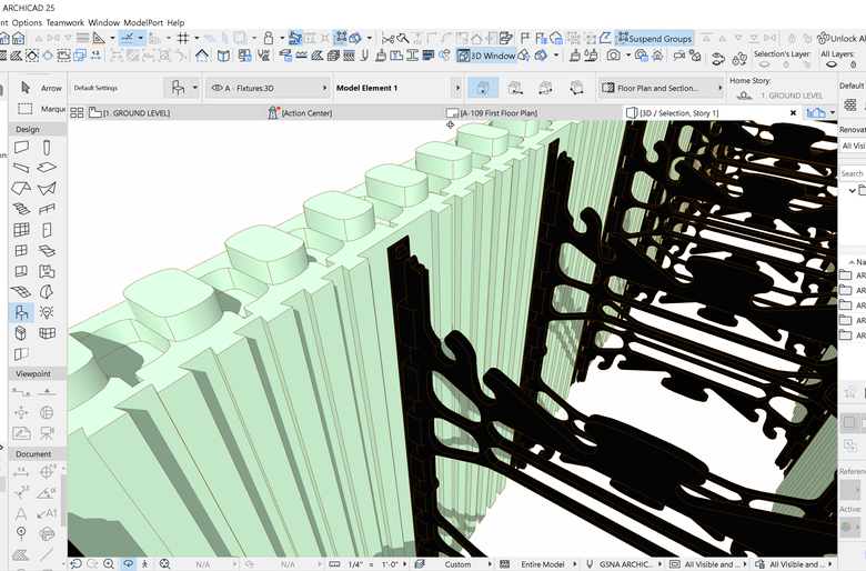

The  https://www.nudura.com/resources/design-library/bim-library/  has is .rfa only.  I could convert them except it seems that they are older than a 2015 Revit version.
Does anyone have a solution for getting these parts into .gsm parts ?

To answer my own question --  Download the Revit 2025 Demo.   Download the NUDRA Revit Template BIM Library | Nudura Design Library
Open the Template and do "Cancel Upgrade". Do not upgrade NUDURA Revit Template.
ArchiCAD (even 28) will not open version 25 .rfa files.   The Template file is a version 2021 .rfa it will work better with ArchiCAD collaborations.
That template has the NUDRUA .rfa objects.    From there you can export them as IFC objects ( there are settings for level of detail land such). The IFC files you export from Revit open with ArchiCAD very nicely.
I am not bothering to try and explain the steps with Revit - I barely know how to open it.  I leave that so someone else.
If I can do it - anyone can.  It's a similar process for all the manufactures with so-called "BIM" Libraries which they seem to think is synonymous with Revit.  Hope it helps someone.
