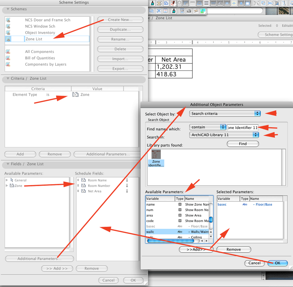

I took the default ArchiCAD 11 new project template with standart profile. Made a zone - where in <Floor Type> I typed my floor number - for example 14. So - the next step - I took Lists -> Zones -> Rooms/Zone Categories (AC11_INT) - and in calculated list - there is all data in all listed columns excep Floor type column - which is just empty. So where is my number 14 of my floor type?

You can customize any list scheme or element schedule (previously called 'interactive schedules'). You need to add the fields that you want to see. In particular, some fields are part of the element (tool) - while other fields depend upon the actual library part associated with the tool (objects, windows, doors, zones and such). In this case, the chosen Zone Stamp 'stores' the additional data, and you have to specify the fields to be displayed.
Attached is a simply zone schedule that shows the floor finish code associated with the Zone Identifier 11 zone stamp. Not sure if this will be the same zone stamp you see in your localized or INT version. Unlike a list, this report can be edited like a spreadsheet, updating data for the zones.

Here is the setup. From Scheme Settings, click Create New, give it a name, and set the Criteria to filter just zones.
Under Fields, expand Zone and choose the fields you want clicking 'Add'. Dragging on the double-headed arrows to the left of the Schedule Fields entries lets you reposition this into the order that you want. You can create subtotals and more - explained in older posts on this forum and in the Help.
To get stamp-specific fields (floor finish code in your case), click the 'Additional Parameters' button, then find the zone stamp you used and then locate the parameter associated with that code, click Add and click OK as shown.

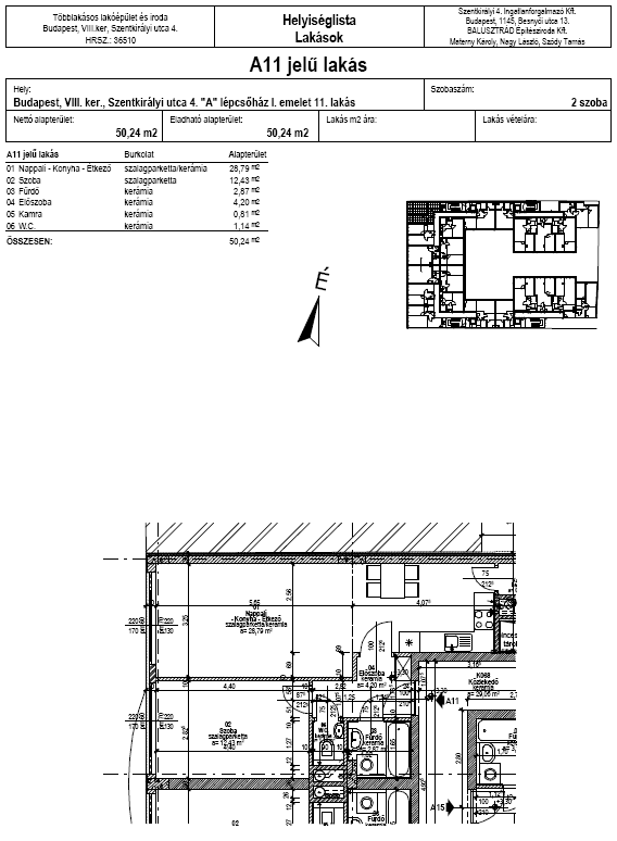

Another example of the use of the old calculation capabilities:
The text and line items appearing on the page were all generated automatically by the listing functionality of ArchiCAD.
