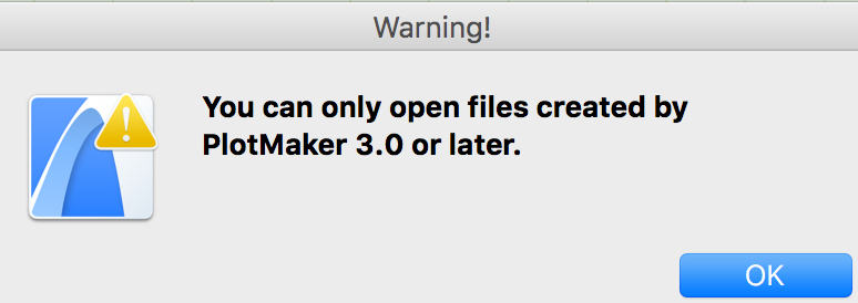

Dragging any of my old circa 2001 / 2002 PMK files into any of AC 10 through AC 20 pops up a message saying that only PMK files created with PlotMaker 3.0 or newer can be placed on a layout.
Digging into my old Snow Leopard boot clone, I see that AC 7 used PlotMaker version 2.3; AC 8.1 used version 3.1 and AC 9 (final PlotMaker) used version 9.0.
So... if Mac is your only option, it would appear you would need the capability to reboot into the old Snow Leopard OS in order to run AC 8.1 or AC 9 to convert the PMK files using the version of PlotMaker included in those versions. Those versions of AC were written for the old PowerPC Macs... and Snow Leopard allowed Intel Macs to emulate PPC code using what was called "Rosetta".
If you don't have the ability to run Snow Leopard - you might have to find an ancient Mac or an old Windows PC (or virtual machine) in order to run the Windows version of PlotMaker included in 8.1 or 9 to do the conversion ... or re-open the original PLN in those versions of AC and republish the PMKs.

I could not agree more and was, frankly, VERY surprised that there was a limitation. I got exactly the same error message in EVERY version I tried accessing the PMK, until I got to 7.0.

I've decided to post one of the PMK files that I received and as I said it came off of a disk that was labeled 2001, so my guess is that this file was created on 7.0 or earlier. Frankly, I'm thinking it was 6.0 after looking at the PMK files, but it is really just a semi-educated guess . . . . I tried removing the PMK extension so if you try opening it, you likely need to egg the PMK back on. . . . . never mind all of that, this forum system will not allow me to upload a file with a PMK extension so I am now trying one zipped . . . .
Eduardo Rolon
and I think I confirmed Karl's culprit.

I got that same error right up until I tried using AC 7
