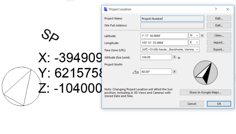

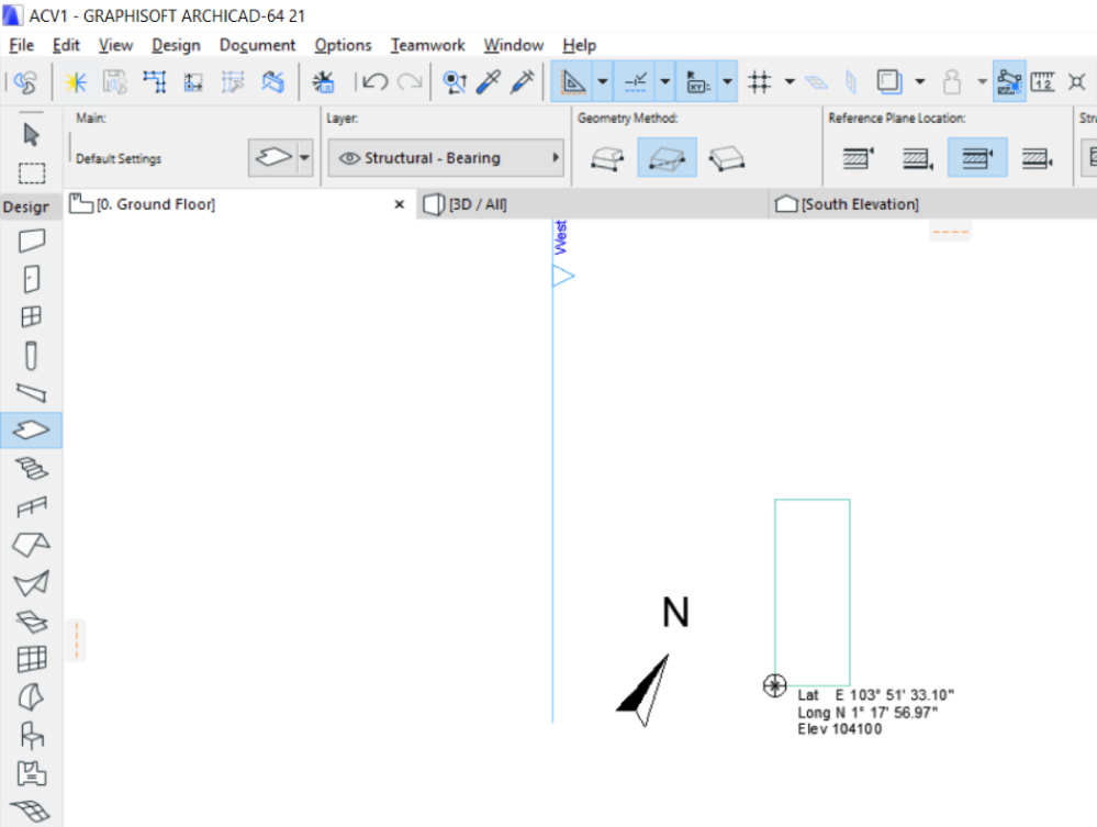

Project Location – Archicad
Gateway East was used as the project location to simulate the real-world scenario, Lat and Long values were obtained from Google Map.
1., Start settings from Archicad. Archicad 21 INT version was used to do the settings
  • Set the Lat and Long as 1.299158 and 103.859194
  • Choose the Time Zone as (UTC +08:00) Kuala Lumpur, Singapore
  • Set the Sea Level as 104 meters (just an assumed value)
  • Leave the project north as 90.00
Note: Show in Google Maps… shows the exact location in google map and helps the user to verify the input.
2., Save as IFC using your preferred translator.
Just make sure Match IFC Site Location with: Archicad Project Origin is set in the Geometry Conversion for IFC Export.
The translators can be accessed from the menu File/Interoperability/IFC/IFC Translators…

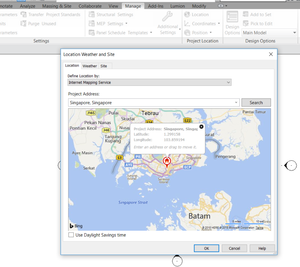

4., Make sure the latitude and longitude were transferred correctly from the menu Manage/Project Location/Location. Project address might be shown wrongly, and It does not affect the coordination
Note: Step 1 to 4 need to be done to make sure we can set the latitude and longitude correctly in Revit as we need to export this back to Archicad

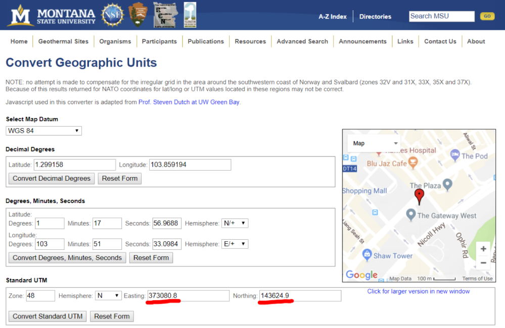

5., Use reliable web tools to convert the Lat and Long to UTM and check on the map tools to verify.
http://www.rcn.montana.edu/Resources/Converter.aspx
was used for this testing and accessed on 7 Mar 2018.

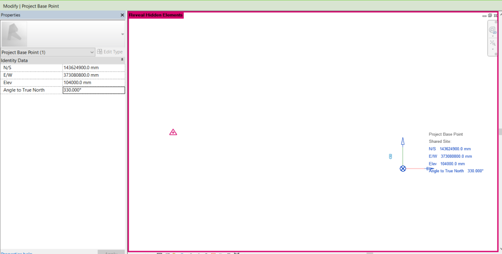

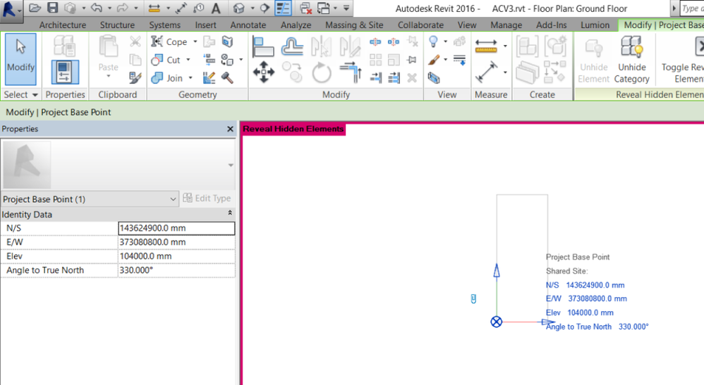

6., Enter the UTM values to PBP in millimetres (During input in Revit just add “m” at the back of the input to indicate the value entered is in meter). Enter the angle for true north. Let us assume the angle is 330˚
Note: Default the PBP is hidden in Revit, click on the lamp icon shown in the image below and Zoom to Fit to see the PBP. Once the UTM values were entered the PBP might move and go out of view, just Zoom to Fit again

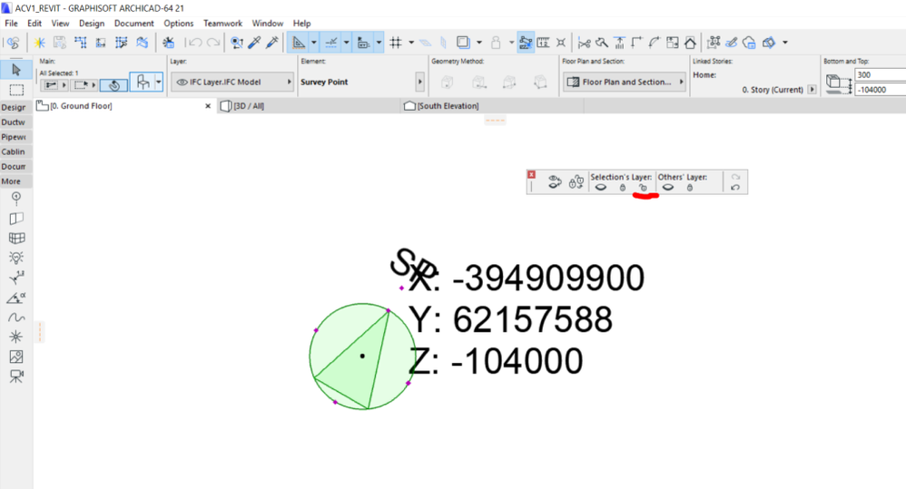

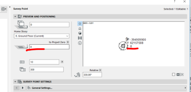

8., Launch a new Archicad and open the IFC file, Archicad import will automatically place a Survey Point (SP) Object with the rotation based on Revit settings. Zoom to the SP, select it and unlock the layer and copy to clipboard (ctrl/cmd + c). Quick Layer palette shall be used unlock the layer by selection.
9., Switch to the actual project or the file started at point 1 and paste the SP from the clipboard (ctrl/cmd + v). Choose Original Location for Where to Paste:
Note: We need to go through these steps so far to make sure we set the SP in the right location in Archicad so that when exporting IFC for Revit UTM values for Revit’s PBP will be maintained. In Revit this SP will have 0,0 and PBP will have the UTM values. Please ignore the X and Y value of SP
It is good to change the layer of SP to a unique one and lock it or lock the SP in Archicad
10., Last step is to set the true north in Archicad. This can be done from the menu Options/Project Preferences/Set Project North. Once the tool is active pick the centre of SP as a base and the angle same as SP. This step will set the project north same as SP

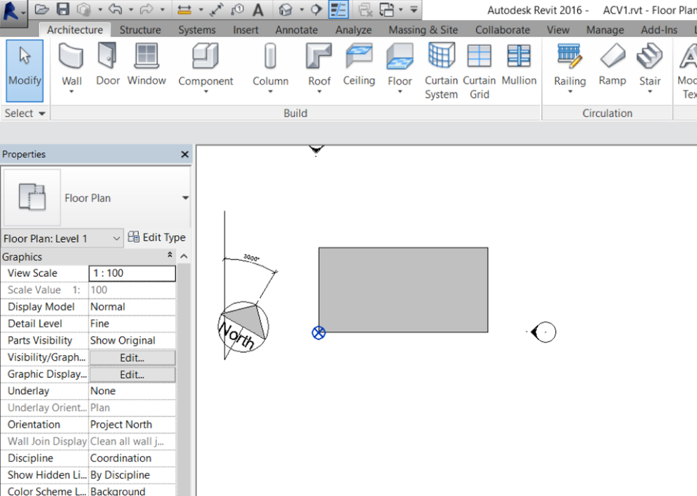

  • True north angle is 330˚ in Revit that is measured clockwise from the positive Y axis. In Archicad the angle is measured anti-clockwise from the positive X axis
  • In Revit when the user set the true north, the axis is rotated and have an option to switch between project north and true north
  • Switch to true north, place a north symbol and then switch back to project north. Now look at the symbol from a project north view then it will be rotated 30˚ That is what we need to input in Archicad
  • In Archicad, the user set the true north independently from the axis. The default true north setting is 90˚. So, the angle 30˚ will be set as 90˚ – 30˚ = 60˚
  • Select the survey point and change it’s Z value to 0. Otherwise the elevation will not match in Revit
11., Zoom to the origin, place the objects World Coordinate Dimension 21 at the origin and North Symbol 21 nearby to verify the settings

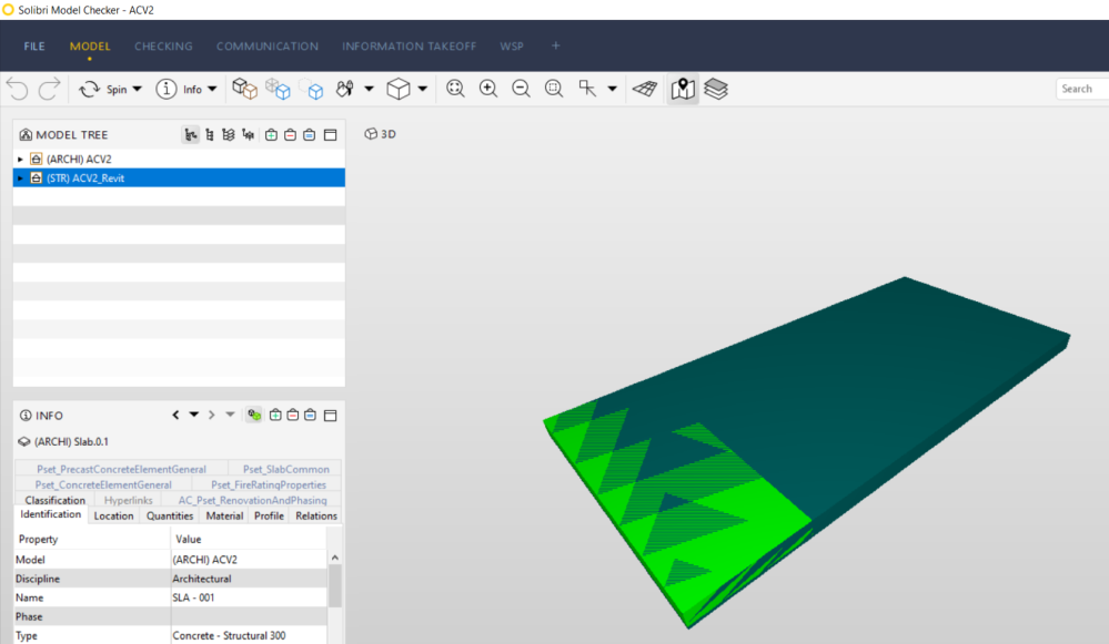

13., To verify the correctness between Archicad and Revit, model some elements near Archicad’s Origin and Revit’s PBP as shown below. This example uses slab
14., Export both the models to IFC, make sure the settings are taken care. Import them into tools like Solibri Model Checker or Tekla BIMSight to verify the correctness of the settings. The slab from Archicad is highlighted in light green. This shows Archicad’s origin and Revit’s PBP are coinciding and the orientation is also correct.
15., Import the IFC file from Archicad into Revit and you will be able to see the UTM values along with the true north angle correctly as shown below
