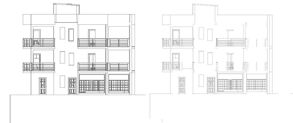

Please help saving a section from archicad to dwg and open it in autocad half of the lines are hidden adn i cant do anything.Choosing the hidden lines and bring them to front hiddes other lines.It is annoying and frustrating and the problem is that I needed the sections for today and left it till the end and know i have this major problem!!!PLEEEEASE HELP ME! On the attached images you can see howthe front view looks in archicad and how it looks in autocad.....

if you are not thinking of editing that in Autocad , try while saving to .dwg to use "as out put" translator , and for sure check the scale...some might line types are affected by scale .

I did try all the formats of saving to dwg and the result is the same.I ve also tried to change all the settings of the output format and again the same .What Im trying to do now is work the other way around.Import the things i need from autocad to archicad and work in archicad.Do it the opposite way may work but that still doesnt solve th eproblem.Thanx anyway for your advice.

Try this:
Inside the section/elevation settings in ArchiCAD disable the option "fill uncut surfaces with..." (under model effects) and publish again the section as DWG.

Thanx a lot petro.Kalh sou mera.Mou xe spasei ta neyra. 🙂
