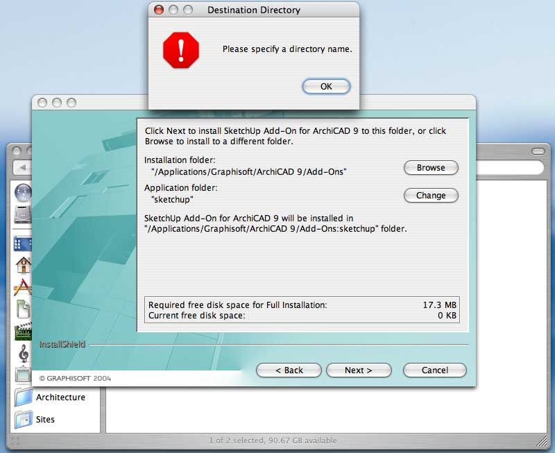

I downloaded your SketchUp Add-On for ArchiCAD and it will not install.
When it gets to the Folder Installation Page, the Installation Folder defaults to "/Applications/Graphisoft/ArchiCAD 9" and the Application Folder defaults to "". When I add a Application Folder name, I keep getting the Error Message titled: Destination Directory, stating "Please specify a directory name."
One thing I noticed is that your installation program is writing out the file directory in Windows format instead of Mac format, meaning when I redirect the file, it writes "/Applications/Graphisoft/ArchiCAD 9" instead of "Applications:Graphisoft:ArchiCAD 9". This could be the source of my problem, but I do not have an option to write in the correct directory.
What am I doing wrong? Everything I try gives me the same message and will not allow me to go further in the installation process.
I am using an iMac G5 on 10.4.5 operating system. I also have MaxonForm added to AC.
Has anyone else had this same problem? Or does anyone know how I can get this installed. Both programs are very important to me, so this Add-On has been greatly anticipated... only to have it not install!

The window indicates "zero free disc space". Could that be the problem?
I saw that too. However, if you look at my Finder bar behind the Graphisoft green window, you can see that I have "90.67 GB available". My hard drive properties say the same thing.

do you have administrator rights on your machine? You may not have the permissions needed to install software in that directory.
Also, you do have the Mac version, right? Not the Windows one?
Tom Waltz
Yep, got Admin Rights
and got the Mac version.
One thing I noticed is that the folder separation in the program is a slash "/" as separated in windows, NOT a colon ":" as Macs normally separate folders. You can see that once I created the Application folder "sketchup", the program correctly set the file structure as "....Add-Ons:sketchup", but did not correct the previous portion.

Dear SmileyMan,
You do not need to modify the installation folders manually. The installer should automatically find your ArchiCAD on your computer and install the Add-on correctly.
However you can also set the paths manually.
Installation folder: /Applications/Graphisoft
Application folder: ArchiCAD 9
Then it will install the files for the SketchUp Add-on into a folder called SketchUp into the Add-ons folder.
We will write an explanation onto this page of the installer next time we update the Add-on.

I finally got the problem fixed. A Graphisoft Tech here in the US figured out that the SketchUp Add-On will not install on the new MacTel computers. The MacTel computers run the OSX software differently than the normal G5's.
His solution was creating an .sitx file for me of all the files. I downloaded them and placed them myself in the Add-On folder. That worked!
