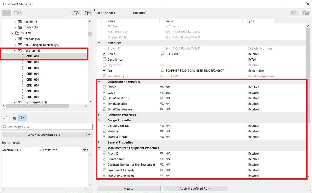

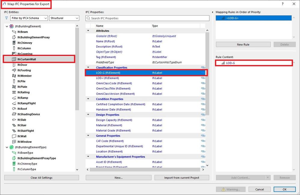

I’m trying to use the defined property mapping rules in “Map IFC Properties for Export” (Figure 1), to link the all properties in native to each IFC entities. Most of entities were successful mapped, e.g. IfcWall, Column, Slab, Door (Figure 2).

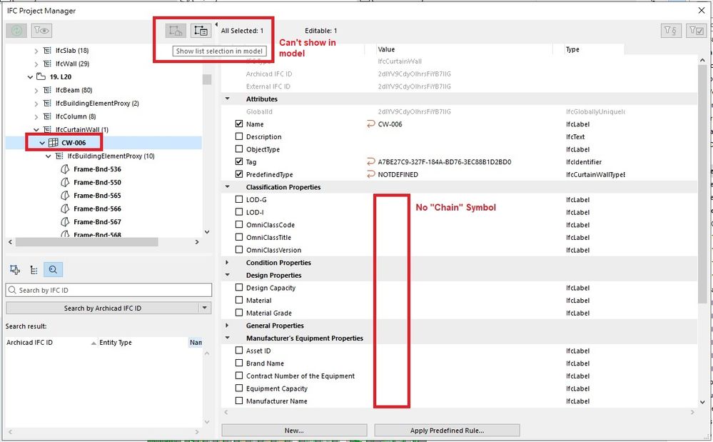

However, both IfcCurtianWall and IfcStair were fail to map, no properties information were displayed in the IFC Manager (Figure 3). Even no chain symbol shown for these entities, seems properties mapping rules fail to apply. Nevertheless, the “chid” under IfcCurtainWall like IfcBuildingElementProxy or IfcMember were successfully mapped (Figure 4). Is it elements with hierarchy e.g. curtain wall and stair, only the “chid” would applied the property mapping rules, but the “parent” can’t? Is there any solution to map these all?

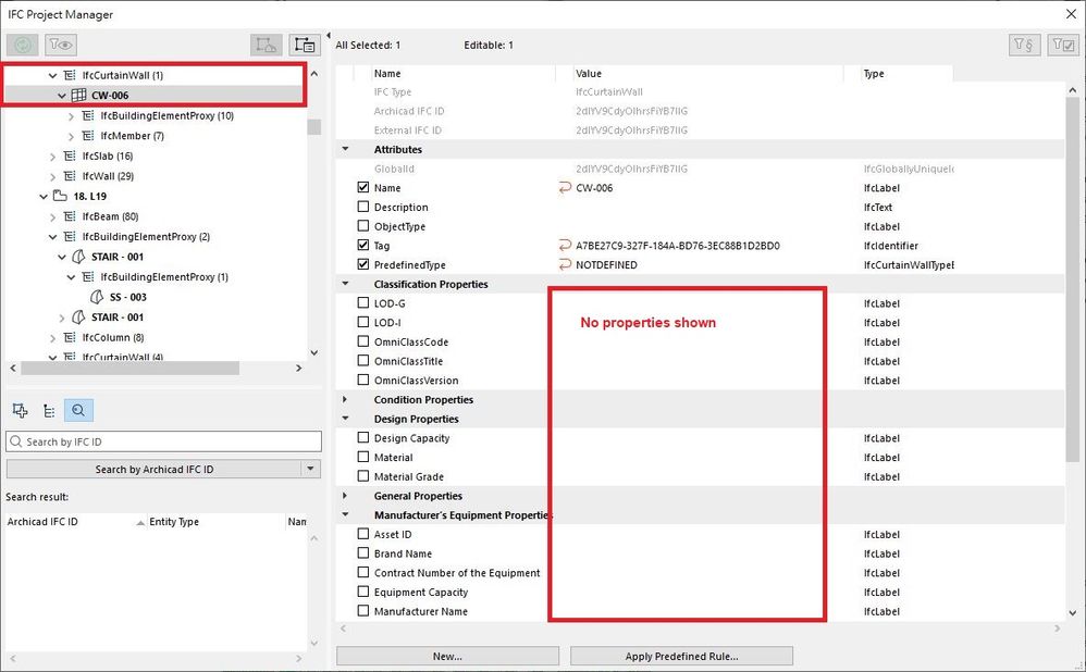

Note: Why these “parent” entities unable to select and show in 3D View by button in IFC Manager (Figure 5), but there was IFC entities assigned to them?
Figure 1: Setting in Map IFC Properties for Export
Figure 2: IfcColumn sucessful mapped
Figure 3: No properties mapped for IfcCurtainWall
Figure 4: The "chid" sucess mapped
Figure 5: IfcCurtainWall unable to show in model

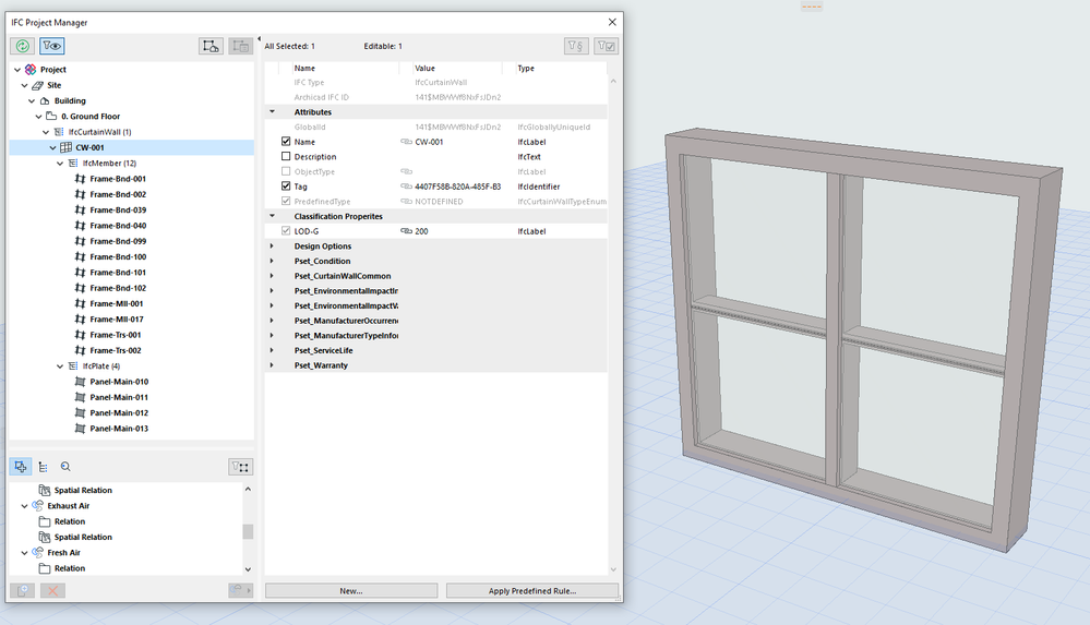

It is working fine for me in Archicad 28 for both the Curtain Wall and all its sub-elements:
