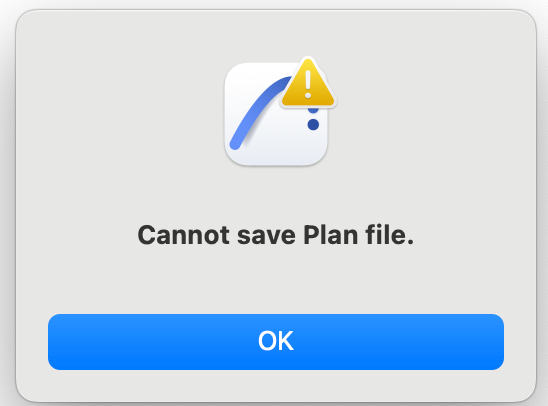

Thank you both for your warm welcome to the club that I did not want to be part of (isn't there a Marx. Bros. quote about this?), and the extensive links to threads that I could not find in my initial forum searches.
I guess it's back to AC26 for me. Funny coincidence, when I try to save as AC26, I get a "can not save plan file" message. Not asking for advice on this, just sharing the frustration.

You didn't ask, but here's a thread with a possible solution to the "AC 27 cannot back-save to AC 26" issue from Graphisoft North America support:
https://community.graphisoft.com/t5/Installation-update/Save-Archicad-27-to-26/m-p/570820
naomihansen
Thanks Karl, this did indeed fix my secondary problem without my needed to search for a solution. Very much appreciated.
