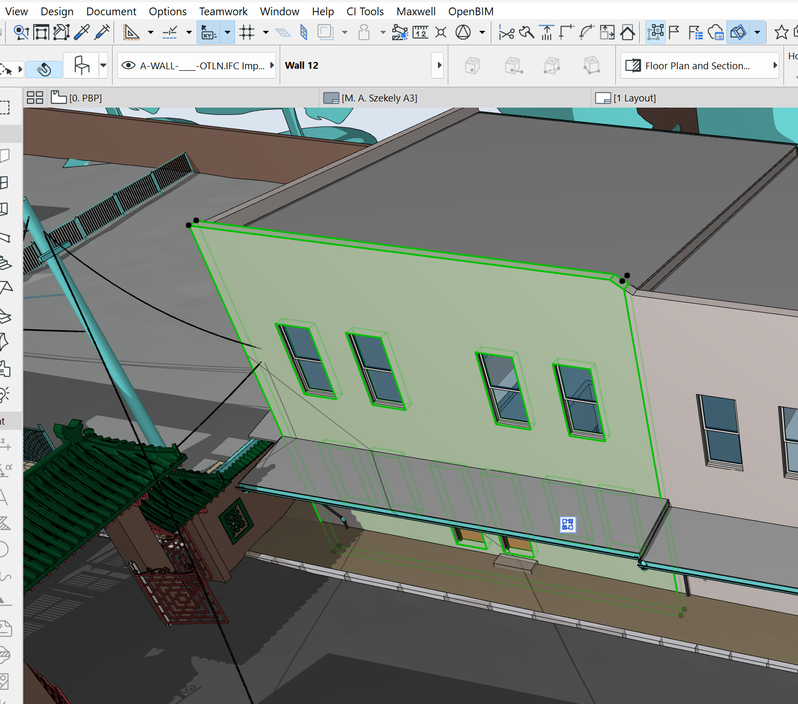

One of the biggest issues is that certain walls from Revit are being converted to .gsm objects. This makes them useless, you have to redraw them. This tends to happen with walls that use profiles.

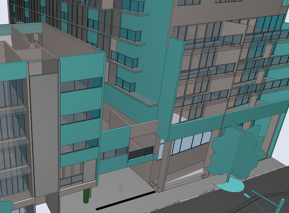

The other issue is that NURBS objects mesh badly and become low poly, which is an issue with the exporter. Unfortunately my only workaround has been to hotlink the RVT, then copy certain objects across. There is supposed to be the level of detail for element geometry, but in my experience this setting doesn't really do much. Everything is still low poly. This can look awful in particular for elevations.

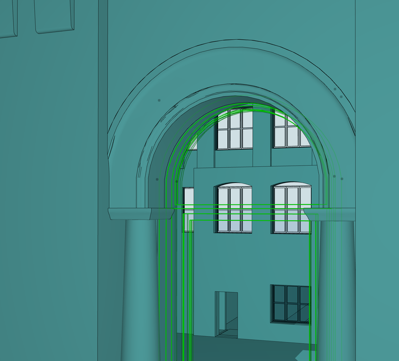

I have tried using IFC4 Design Transfer View, which does import NURBS but also causes BREP problems with walls that would otherwise be fine (see attached, BREPS in blue)
And yes, the best bet is to import IFC and try to modify anything that comes in converted. You do need to take a close look. You may have to make changes in Revit specifically for this purpose, and then modify in Archicad. I have not worked with any Revit engineering files, so your mileage may vary.

IFC2x3 Coordination View 2.0 is still widely used. And it has some support for extrusions upon export, but every time you have geometry that is not a strict extruded shape, it will become BREP. This is try for Archicad IFC export and for Revit IFC export.

And finally, the IFC4 Design Transfer View supports more editable geometric definitions. However, this has to be set upon export from the source Revit file. If you just received an IFC from somebody and it's not exported as Design Transfer, you cannot do anything about it.
