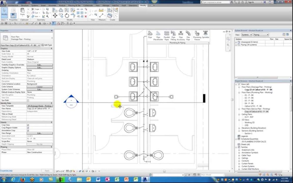

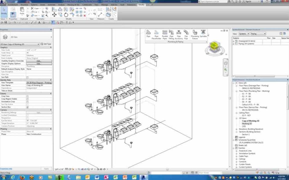

Is it possible with MEP in Archicad have a riser diagram o wiring diagram such us in the video in revit at the minute 1:26?
https://www.youtube.com/watch?v=BOyL3gRfPTA

Mario Sacco
An other image

Steve Jepson
The Revit MEP Modeler seems more functional than the ArchiCAD MEP Modeler, but yes, we can model that using the ArchiCAD MEP Modeler - or without it. There are some examples on youtube
https://youtu.be/bTKGN2pJD2A
https://youtu.be/m9dIqa4zAys
https://helpcenter.graphisoft.com/videos/graphisoft-mep-modeler/graphisoft-mep-modeler-mep-modeling-...

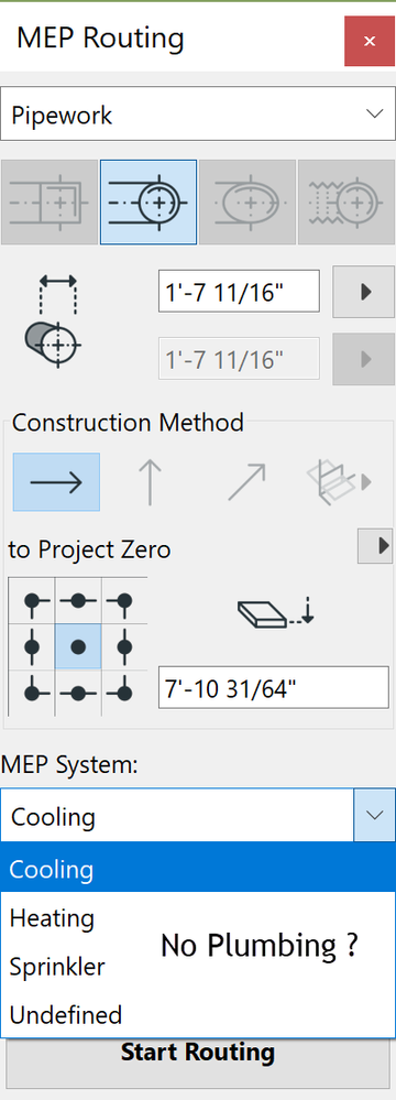

Steve Jepson
GS does not seem to be placing enough importance on the ArchiCAD MEP Modeler.
For example, how is it possible that they thought it would be OK not to include a Predefined MEP System category for Plumbing in the Routing dialog box ?
And fitting types for Pipe are only for welded and flanged connections.
We have to find or make our own fittings and save them as MEP parts.
