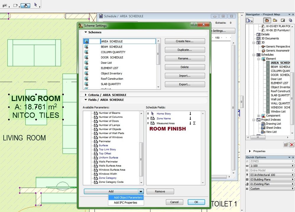

Hello,
I need Room Finish in my Zone schedule list, but it is not showing in Parameters even it does not exist in Additional Parameters...( Ac 17 )
What else can be done to bring Room Finish in Schedule.
Image attached for reference.
Regards,
Ratna

When you select the "Add Object Parameters" button you must then browse the list to find the zone stamp in your library.
Once you select that you will see a list of all the available parameters you can choose from.
Your "Room Finish" should be there but the parameter may not be called "Room Finish" - although it should be something similar.

Thank you Barry very much for your quick reply,
finally found Room Finish Parameter in the list of Additional parameters,
Basically I was searching in the same but it may be missed by me..
Thanks again.
