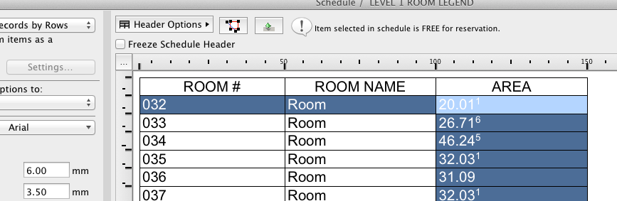

I am making a room schedule on some floor plans and just need to list Room #, Room name, and the area of the room. I have it set up, but for some reason the areas are displaying strangely. For example, if a room is 50 meters squared, rather than showing as 50 m2 or just 50, it sometimes will show up as 50^2 or 50^8 or whatever. Any ideas why it's doing this or how to fix it? I've attached an image to show what it's doing. Thanks

Check under Project Preferences the settings for Dimensions and Calculations

and the other one.
If I remember correctly for the dimensions settings that can/should be saved with the View of that particular schedule.

Thanks for the help. I was able to fix it by setting the "Extra Accuracy" dropdown in the area calculation preferences to "Off".
