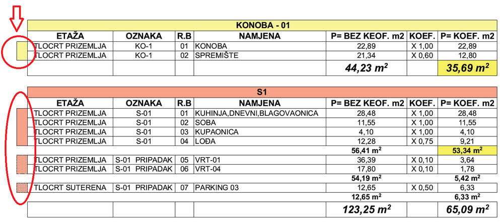

Schedule cell background fill
hi ! can some one please tell me if in AC 20 or any, is it possible to get the cover fill type to show in a schedual like this ? accordenly to the specific zone .
Thanks !
3 REPLIES 3
If you mean that Schedule cells can have a background fill or not, then the answer is NO, even in ARCHICAD 20 you cannot specify a background fill for Schedule cells.
(I moved this to a new discussion as the other was about something else.)
James B
In AC20, you can schedule a 2D Plan Preview of Zones, which will show the floor plan appearance. These generic previews (available for all construction elements) has a fixed size, to show the type in a legend.
James Badcock
Graphisoft Staff Product Manager
Hey, James, I was not aware of this.
This almost looks like a good Zones Legend. I will have to take a lot at the potential of these previews in creating other types of legends.
