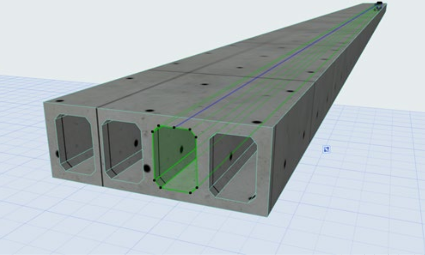

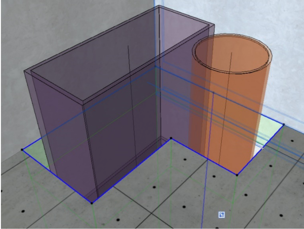

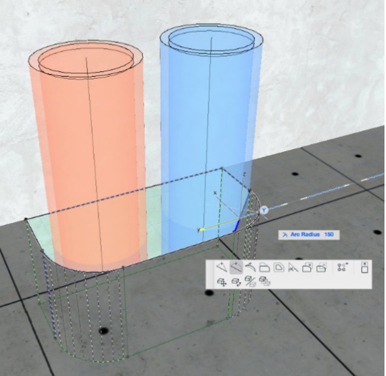

Expanded Design Freedom with Polygonal Openings
Thanks to the new polygonal geometry method, the Opening tool is more accurate and adjustable to your needs, allowing you to achieve more precise quantity estimations. You can design any Openings - in addition to the existing rectangular and circular geometries.
Thus, in Archicad 25, you can generate more accurate schedules and quantity take-offs thanks to more accurate models. You can create by Magic Wand any custom-shaped Opening or convert existing rectangular and circular geometries to a polygonal shape, using standard polygon editing functions in any 2D or 3D view, including Sections and Elevations.

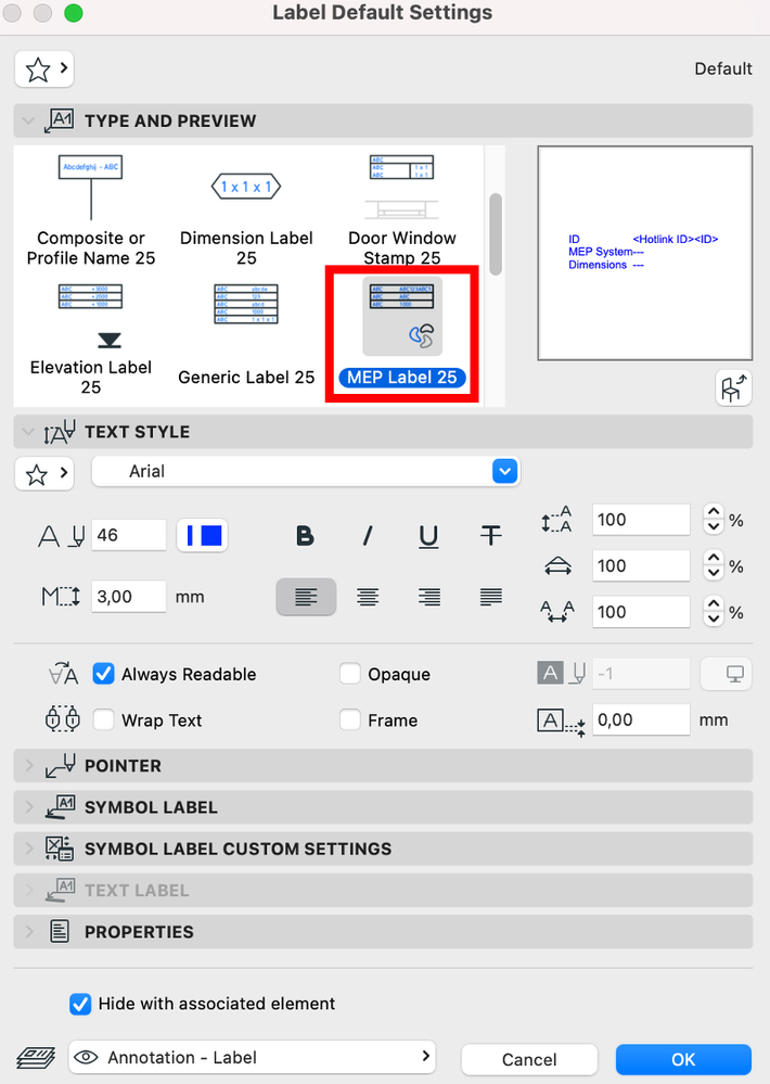

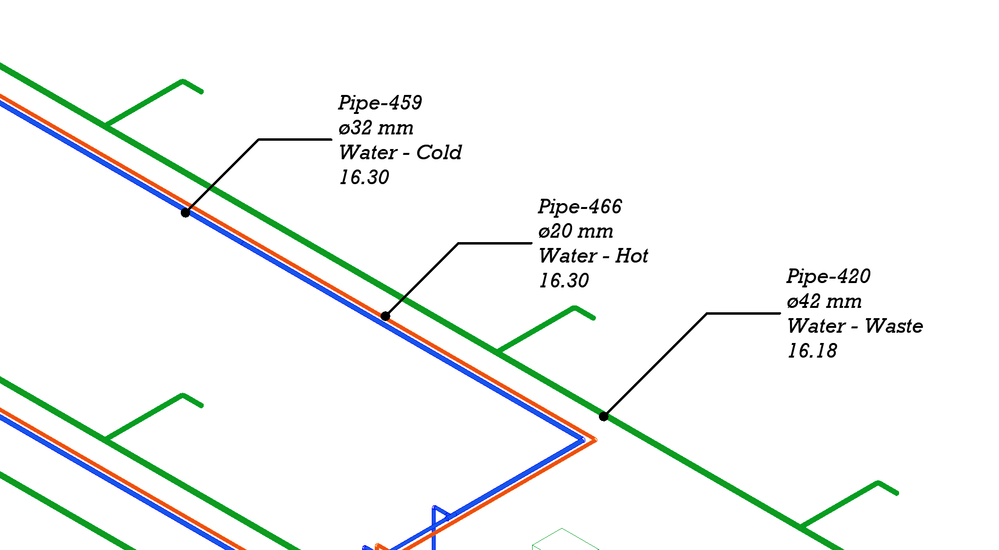

A New MEP Label has been provided with MEP-related element data, such as MEP System or duct diameter. You can also change the general settings such as text and pointer as per any other Label Type.
There are some unique options for this label type within the Symbol Label Custom Settings tab. You can change the displayed data, meaning that you can choose whether to display the value only, name and value, prefix and value. The prefix for each data type can be set at the related field, and each info type can be turned on and off.
You can change settings for the displayed dimensions and add additional properties (up to 5 rows).
The display order can be easily changed, allowing you to customize the label further. Moreover, instead of using Project Preferences settings, you can overwrite it and use mm-s instead. The labels can be placed on any MEP elements, both on 3D documents or 2D View.

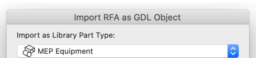

Native RFA and RVT Exchange
Another significant improvement of the workflow, import RFA as GDL Objects (previously available in an Add-on) is now integrated into Archicad for easier file exchange with Revit file formats up to 2021.
With Archicad 25, it is possible to import RFA as GDL Object, which now also supports the creation of MEP Equipment from Revit Family Files. MEP Objects inherit data and connections from the original RFA file are now available for connection to Duct and Pipe elements.
