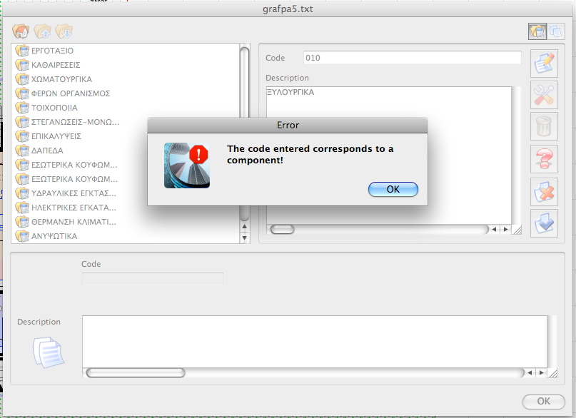

While you answer i have another question...
I try to create a new chapter with code 010, but every time i get an error message stating: "The code entered corresponds to a component"
Why???

Hi Achille,
I0m sorry but I'm not able to answer in "real time" and it's quite difficult to me to address the same question both on our Forum and on ArchiCAD-Talk.
But here I am... finally!
Ok about the first question, any components is "inside" a certain chapter not because it really inside it (I mean contained into it) but because the first part of his code refers to that Chapter.
For example, just to be clear, if you create a Chapter with code "010" and then create a component with code 010.020 this component is assigned to the Chapter (just because its code starts with "010").
If in the same Component Archive you have a Chapter with code "020" in order to move the created component inside the second Chapter you can edit the component and change its code from 010.020 to 020.020 and when you will save it you will have that component in the desired Chapter (but the original one should be manually deleted ).
Otherwise, as dirty workaround, you can open you Component archive by using a TXT editor and manually modify (using the same logic) the component code (in this case you won't need to delete the original one because you are just changing it).
I know, once again, it's not the best solution... as I told you we are thinking about a drag&drop solution that, for sure, will better fit to your kind request.
About the second question it sounds just a bit strange... Could you be so kind to send me your active component database?

About the error message, today that i tried it worked, so consider it solved.
