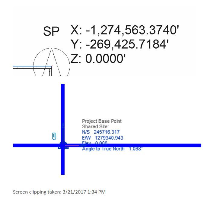

I am attempting to coordinate a model generated in Revit 2016 that is on State Plane with a model created in Archicad 20 that is modeled close to the Project Origin. The issue that I am having is that there doesn't seem to be a way to accurately export the Archicad file located in State Plane https://en.wikipedia.org/wiki/State_Plane_Coordinate_System.
The goal is to be able to consistently export a model out of Archicad 20 that is relative to State Plane Coordinates so that I can generate single model that are referencing two files in either Navisworks or Solibri.
Any suggestions on how to achieve that would greatly appreciated.

That doesn't seem to solve the issue. Even when I open the IFC file that was created in Revit it is brought in at an arbitrary location that isn't necessarily relative to State Plane.
The issue surfaces when I try to bring in the two models into Navisworks. One is located on State Plane Coordinates the other from Archicad is 2million feet away from that location.

ares997
Thanks for the response. Very helpful though a little confusing as to which way is the best way to share the coordinate system between two different files.
When I export the file from Revit as an IFC with the Add-In and then open it up in Archicad the SP (Survey Point) ends up at some location not necessary where it was placed, for instance I have the survey point located at the intersection of two grid lines in the Revit file and it ends up a million feet away from that original location. Which I think I understand as it is putting it somewhere that is relevant to the origin but also related to the original location of the SP.
So in an effort to create a shared coordinated I just copied that SP from the file that I just imported and pasted it into my working Archicad file thinking that when I export it I would now have this shared location between the files. But instead the file gets pushed into a different location.
At this point I am going to try and just import the project that I have created in Archicad into the Archicad file that has the coordinate system in it that is exporting correctly but that isn't the ideal work flow.
I would like to be able to establish a known location so that when I export out of Archicad with the correct SP location I can import it into either Revit or Navis works consistently as I make changes to the file.
Any more references or suggestions would be great. Thanks for your help and comments thus far I greatly appreciate it.

I can't figure out how to get these models from various different authoring tools to align correctly to State Plane Coordinates.
I opened the IFC file created in Revit in Archicad and the Survey Point comes in but it's not the same as one I just exported.
Then when I take the model(s) to Navisworks all the models created in Revit and based on the grid system that I sent to them import in the exact location except for mine which is created in Archicad based on that imported Survey Point.
The thing I don't want to do is have to transform the model to get it in the correct location I would rather have the model that I am creating reference this imported location.
Has anyone had to work with Revit and Navis works with a Archicad file? I'm trying to get all of our consultants to use IFC files for coordination but it seems the only model that is not coming in the correct location is the one created by Archicad.
Any help on this would be great.
