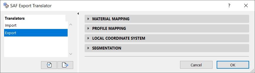

SAF Translator settings for Export
SAF Translator settings for Export ensure that the Archicad structural analytical model is correctly recognized and interpreted by the external structural analytical software. Access SAF Translator settings at File > Interoperability > SAF > SAF Translators.
Translator settings for SAF Export option include the following mapping parameters:
  • Building Materials (in Archicad) and corresponding SAF Materials
  • Archicad Profiles and corresponding SAF Cross Sections
  • Local Coordinate System standards (how to interpret the orientation of columns and beams)
  • Segmentation of curved walls if the receiving software cannot handle them
Use these translator settings to fine-tune and define a smooth model exchange workflow between Archicad and the structural analysis software. For further information, please check out all the following sections from the Reference Guide:

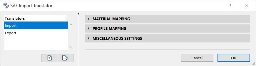

SAF Translator settings for Import
SAF Translator settings for Import ensure that the structural analytical model from an external structural analytical software is correctly recognized and interpreted by Archicad. Access SAF Translator settings at File > Interoperability > SAF > SAF Translators.
Translator settings for SAF Import option include the following mapping parameters:
  • SAF Materials mapping to corresponding Archicad Building Materials
  • SAF Cross Sections mapping to corresponding Archicad Profiles
  • Miscellaneous settings for mapping incoming SAF elements to corresponding Archicad elements
Use these translator settings to fine-tune and define a smooth model exchange workflow between the structural analysis software and Archicad. For further information, please check out all the following sections from the Reference Guide:
