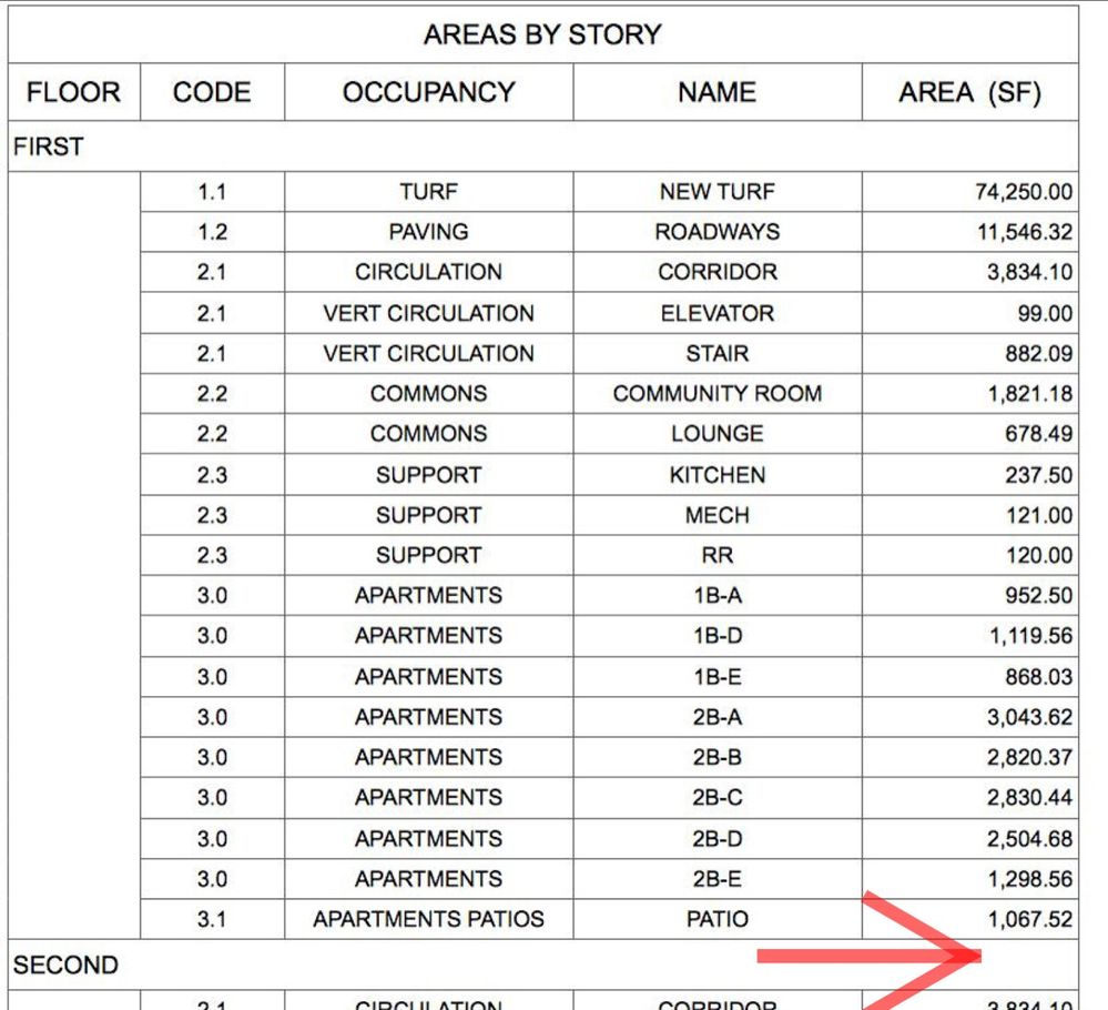

Is it possible to configure a schedule so that the area quantities in a specific column can be all added together??? See attached image.

Yes.

Second question: is it possible to turn off the decimal points in the area calculations? I do not see an option for that.
Srinivas
Units and precision for Scheduling are controlled via the Options > Project Preferences > Calculation unit.

May I ask how did you separate the floors in the schedule?
Can you share the scheme settings, please?

Got it! The 'Show headline' option is the answer.
