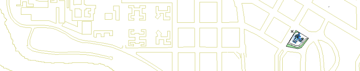

Step 3: Set as Trace Reference on Floor Plan
The Drawing we placed on Worksheet can now be used on any Model or Layout Views as Trace Reference. Select the Worksheet from the Navigator and right-click to bring up its context menu. Choose Show as Trace Reference.
Go to Floor Plan and activate the Trace content.

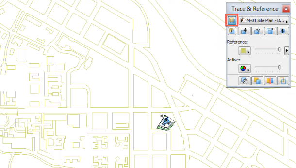

TIP: When working with Trace References, it is worth opening the Trace & Reference Palette, which contains all controls that affect the Reference: Window > Palettes > Trace & Reference.
Step 4: Drag Reference
The Drag Reference command is accessible from View > Trace Options > Drag Reference or from the Trace & Reference palette. Click on the drag command to set the correct position of the DWG Reference. You can use the snap points with elements in the reference, too.
