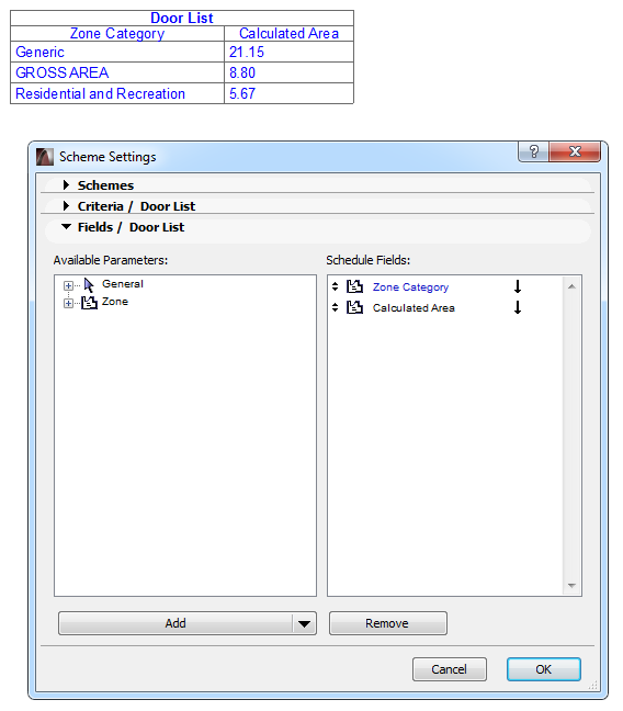

I have a drawing set up with zones of multiple categories and a schedule listing those zones accordingly.
However, the issue I am having is in some instances i would like to have more then one zone of particular category but not have it show up in multiple instances on my schedule.
Instead i would prefer that only the total area for all zones of each category is shown, is this possible?

Like this? (check attached image).
I also checked the Merge Uniform Items checkbox.
However, this raised a question in me. The Merge Uniform Items checkbox doesn't consider items with different Calculated Areas or Measured Areas to be different and will unify them into a single row. In the attached screenshot, those are 9 Zones, 3, 2 and 4 of each category, respectively. Each Zone has a different Calculated Area, yet the Merge Uniform Items checkbox groups them into 3 rows. So I can only conclude that the Calculated Area and Measured Area fields are not considered by it.
I can imagine this to be the case ( I checked back in AC12, even then it worked like this) since the areas of very few Zones is ever exactly the same, but I could not find any info about this in HelpCenter.
Can anyone confirm this?

Thank you Laszlo!
You have no idea how embarrassed I am, i knew it would be as simple as a check box but I was looking in the zone parameters not the schedule!
This is amazing, and will help me immensely!
