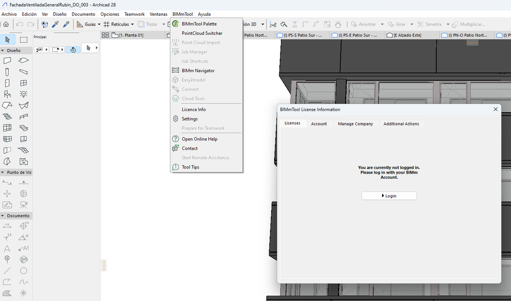

I wanted to try the BIMmtools addon since my 28 license is finally updated and it was announced as a top addition for cloudpoint workflow. But no luck. Reading BIMmtools manual it says that import option is only active when a license is detected. And searching in the license options of the addon, nothing seems to exist. Am I missing something? How do I activate the addon?

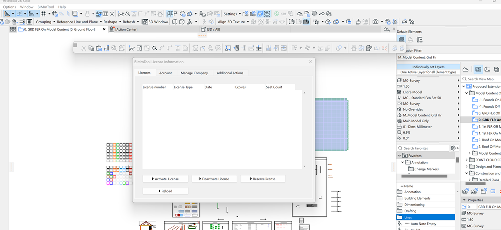

I'm having similar problems. I have already set up an account and activated the Lite version online, however, the license information is not shown in the add-on, nor is it giving me the option to activate the license as none of the buttons are working. It appears to be an overly complicated process. Do you have any suggestions as the company doesn't seem to offer much guidance?
Thanks
