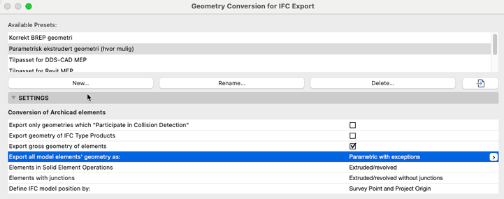

I figured it out, at least the main issue.
The Geometry Conversion-setting / "Export all model elements as:" was set on BREP when it should be set to "Parametric"
Now I can export a wall as IFC and merge the IFC with the walls turning up as walls.

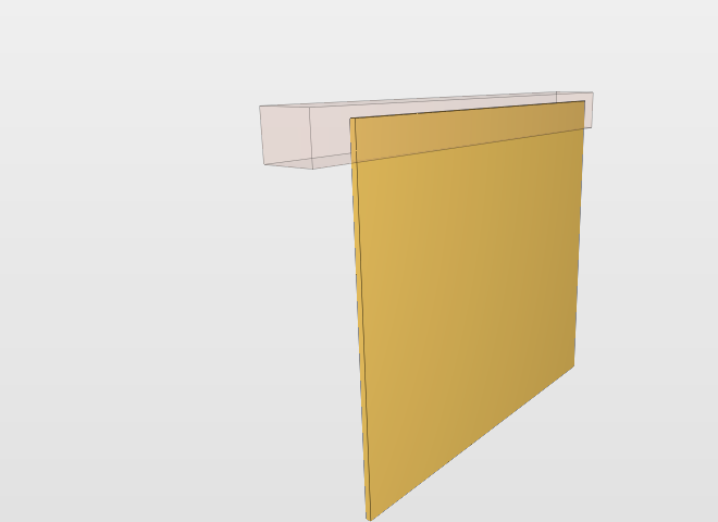

It seems I have to choose between exporting object in a way that let them be imported as their native element, or export objects extruded.
If I try any other setting, like deactivating the "Export gross geometry of elements" (see result in pic below) or setting some of the settings below as BREP there are always some issues with the export/import.
