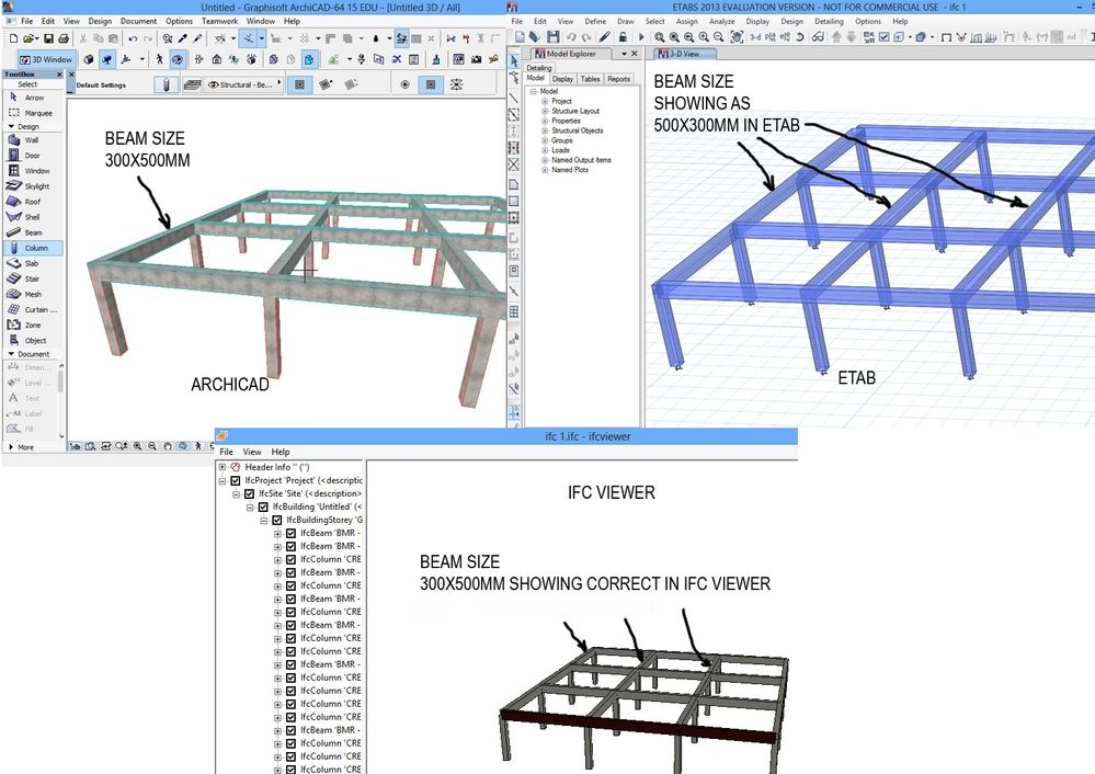

archicad ifc to etab issue.
When I take the IFC file from archicad to etab, vertical length beam dimension changes.

Roopa A
I too have the same problem
Roopa A S
If the IFC Viewer displays it correctly and it is incorrect in eTABS then the logical conclusion is that the IFC Import process in eTABS is somehow causing this error.
So, I would probably contact the developer of eTABS and call this to their attention.
