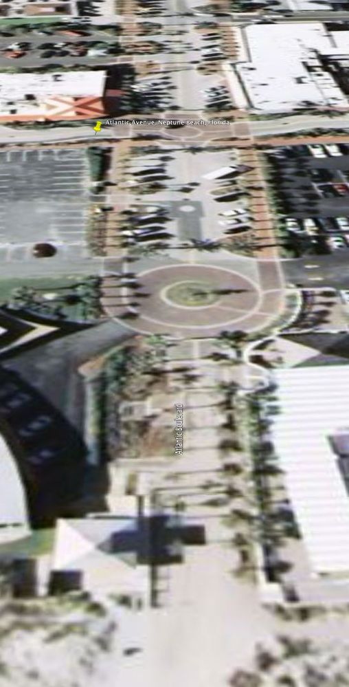

That Google Earth thing is an astonishing feature for me.
For instance, I am often competing for art projects in other cities - places i have never visited. Google Earth lets me [thank you, Aaron!] place Archicad models into well-developed cityscapes and fly around a model that is worth thousands of dollars if you built it yourself provided you could assemble the data in time.
I guess if a guy was drawing up the same windowless swine barn [you know who you are] all the time, the Google Earth thing is a waste. However, I have just visited Neptune Beach in Florida since they need a new community icon. Google Earth showed a number of important axial issues their brief did not. And so it goes.
