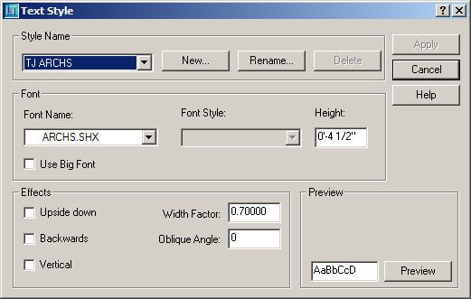

If you don't know anything about AutoCAD, it can be a little daunting attempting a conversion of this nature. Remember that the translator works by translating fonts to ACAD styles. Open ACAD (cringe emoticon missing) ...go to Format > Text Style. It opens the attached dialoge box. In there, you can create a new text style with an appropriate font. You then use that style (not font) in your translator settings.
HTH
undefined
..oh...I almost forgot...make the new style in your DWG template that you will be using for translation...Are you using a DWG template for your conversions?
