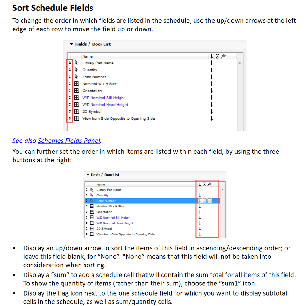

Help tags would be good. There is documentation is in the Archicad Reference Guide
Erika

Thanks Erika,
That is the all explaining simple paragraph that I was not able to be lucky enough to find.
