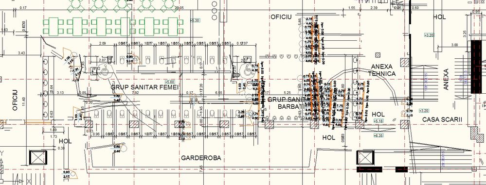

I have an issue : I have imported several plans that I drew in Archicad into Autocad, each plan becoming a separate .dwg file. When I try to unite all these plans into one Autocad file, I lose several lines, from walls, windows are moved inside the plan, dimensions are a mess (see picture).
I tried to explode the plan in Autocad, but it won't work.
Does anybody have a clue?

Thank you for the answer.
I followed the steps and it worked. Now another question lies in Autocad: all drawings are imported as external references and are, as I could understand, editable only one by one.
Is there a way in which the export from Archicad influences this or is this a question of Autocad only?
