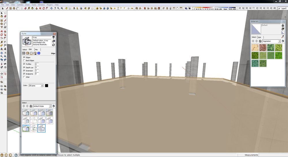

I've saved my archicad file as sketchup file(skp).
When I opened the file in sketchup.
It looks work great but has no edges.
What do I have to do let the edges appear in sketchup saved from archicad?
Thanks.
I've attached my test image with skp format.

Yes, same to me, and it's a pity since I haven't found a way to re-add them in skp. I pass around saving the file as 3ds and reimport in skp.

I've just noticed that ,It's not apparently a style issue. There must be a way to overcome this

Try using save-as using 3DS or DWG as the format. Do not forget in SU to select "hide coplanar edges" in the import options.

Try going to Edit/Unhide/All. Se if that helps.

It exports without edges and imports only as solids. What a joke...
Just to precise that this have to be done in Sketchup
Thanks Gorazd
